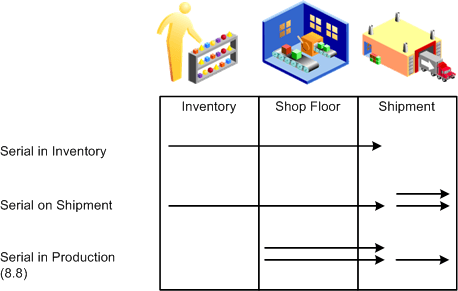

This diagram illustrates PeopleSoft and serial processing prior to Release 8.9
Serial processing prior to Release 8.9

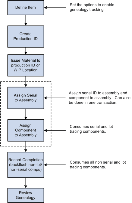

This diagram illustrates the serial genealogy process flow from setting the options on the item definition, to creating the production ID, issuing material, assigning serial IDs to assembly, assigning components to assembly, recording completions, and reviewing genealogy:
Serial Genealogy Process Flow
