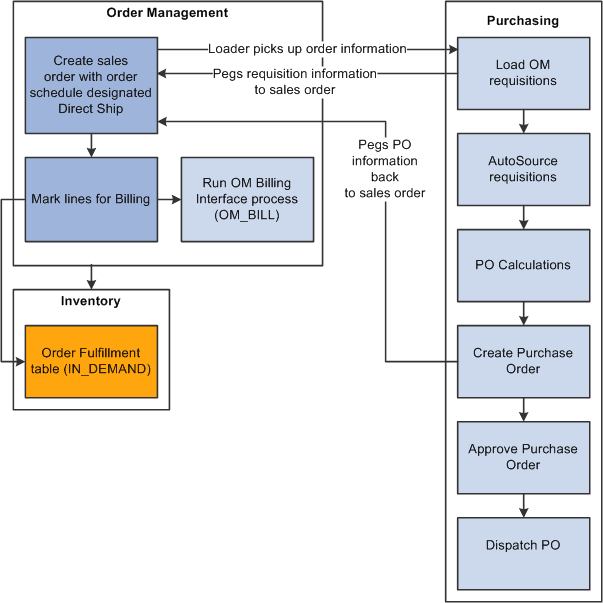

The following diagram illustrates the shipping process flow that occurs for schedules that are shipped directly from the supplier to the customer:
Overview of claimback process flow
Direct shipping process
The steps describe the processing:
  1. The Requisition Loader process in PeopleSoft Purchasing searches order schedules and ensures that the Direct Ship from Supplier option is set to Yes and that the order schedule (ORD_SCH_STATUS) is in Open status.
    The process picks up the order schedules without holds that affect purchasing (PO_HOLD_FLAG=No), where the direct ship from supplier status (PO_DISTRIB_STATUS) is Active. The system creates requisitions, and, if the special handling flag (SPEC_HANDLE_CODE) on the order schedule is selected, it uses the shipping method code (SHIP_TYPE_ID) and carrier ID (CARRIER_ID) on the order schedule for the requisition schedule. This information is passed to the purchase order. If the product is configured, the Requisition Loader process also picks up the configuration code and template ID. When the Requisition Loader process picks up a direct shipped schedule, the system changes the direct ship from supplier status to Processed.
    Requisition Loader creates pegging detail in the pegging tables to peg the requisition to the sales order schedule.
  2. The AutoSelect process loads the information into the staging tables.
  3. The PO Calculations process picks up the information from the staging tables, calculates the prices, and selects the suppliers.
  4. The Create Purchase Orders process creates the purchase order and updates the Order Schedule record with the purchase order number. The Create Purchase Order process creates pegging detail to peg the purchase order to the sales order schedule.
    The instructions to the suppliers on the purchase order are to direct ship the product to the customer indicated on the schedule.
  5. The system inserts a pending line into the IN_DEMAND table for each direct ship from supplier order schedule when the schedule is saved. When the schedule is marked for billing the demand status is set to depleted.
    Run the Mark Lines for Billing process (OMMARKLN) or manually record shipment lines for non-stock and direct ship from supplier schedules using the Mark Lines for Billing page.
    To automatically record a depleted line for each non-stock order schedule when you save it with a status of Open, select the Mark for Billing at Order Save option on the PeopleSoft Order Management business unit Order Entry Features page.
    When you run the Mark Lines for Billing process, you can mark order schedules for billing if a purchase order schedule is matched to a voucher in PeopleSoft Payables. The system inserts the line for direct ship from supplier schedules based on a purchase order schedule level match of the voucher in PeopleSoft Payables and PeopleSoft Purchasing. If the schedule has a value of M (fully matched), the system inserts a shipped line.
    If you run the Mark Lines for Billing process, you must select the Mark Direct Ship If Matched option on the Mark Lines for Billing Process page; otherwise, the process marks all direct ship schedules for billing, regardless of whether the voucher is matched.

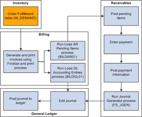

  6. You can run the Journal Generator process for these transactions from either PeopleSoft Billing or PeopleSoft Receivables.
