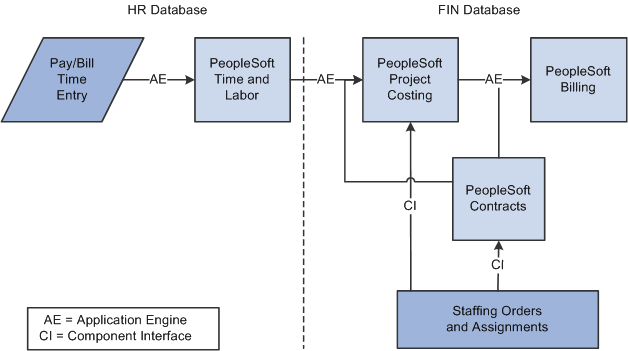

The following diagram shows the integrations between the HCM database and PeopleSoft Billing.
Overview of integrations between the HR database and the Financials database for processing billing
