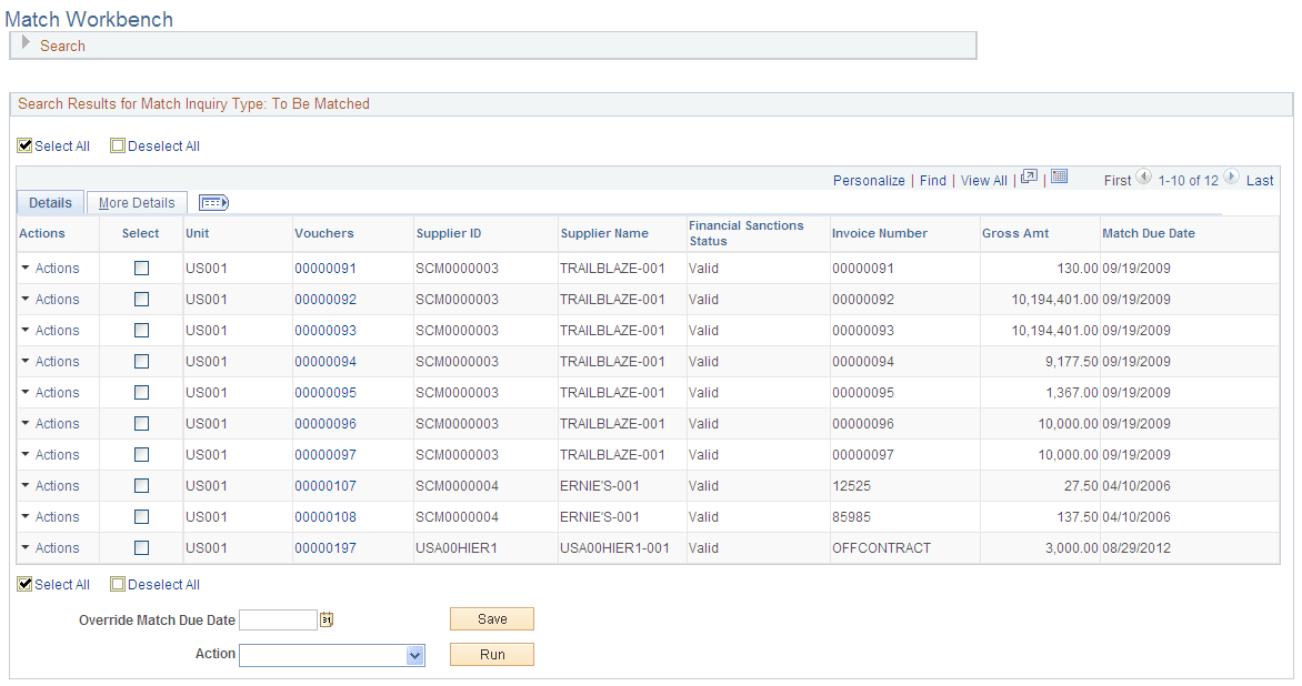

The To Be Matched Link goes to the Match Workbench and uses the filter criteria as the search criteria. The search criteria section is collapsed but can be expanded and refined/changed from the transaction area.

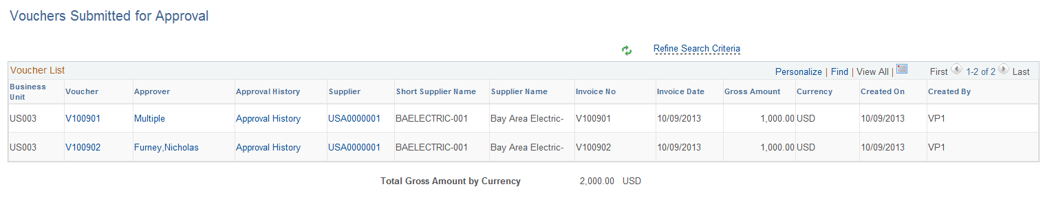

All actions are achieved through field hyperlinks. An example of this style is the Vouchers Submitted for Approval My Work Link.
Vouchers Submitted for Approval page
Actions are available through field links. The field links are, Voucher, which links to Voucher Entry; Approver, which links to an email template to create and send an email to approvers (Multiple indicates more than one approver); Approval History, which shows the graphical approval history for the voucher; and Supplier, which links to Supplier Maintenance

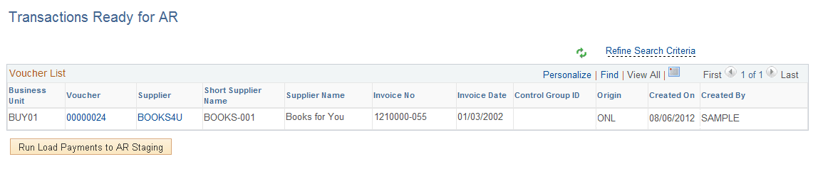

Actions are achieved through an Action button. An example of this style is Transactions Ready for AR link.
Transactions Ready for AR page
On this page, clicking the Run Load Payments to AR Staging action button allows to select AP payments that have been paid and posted but not yet sent to AR by running the Load AR Staging Tables Application Engine process.

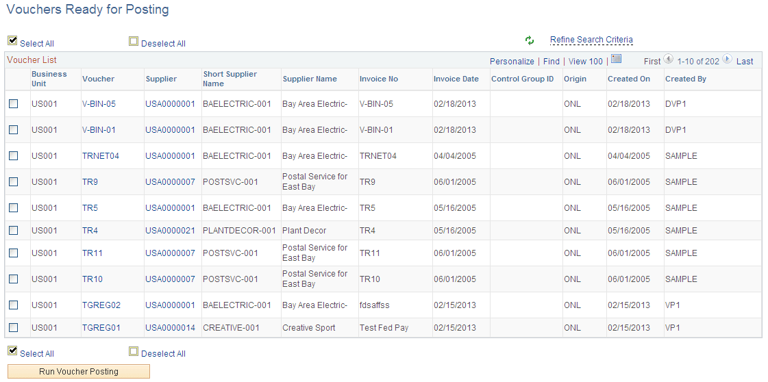

Actions are achieved through an Action button and may be applied to multiple lines. An example of this style is Vouchers Ready for Posting link.
Application grid with select check boxes and action button
On this page, one can select multiple lines and Run Voucher Posting by clicking the action button on the bottom of the grid. The field links are: Voucher, which links to Voucher Entry; and Supplier which links to Supplier Maintenance.

  • Vouchers Submitted for Approval: Click this link to display the vouchers that have been submitted for approval and have a pending approval status. Use the Approver link to create and send an email to approvers. Click on the approver’s name link (or Multiple link, if there are more than one approver) to launch an email template with email addresses of the approvers, Subject, and details of transaction information populated.

  • Vouchers Ready for Posting: Click this link to display a list of vouchers that are ready for posting. Select the Run Voucher Posting button to post the selected vouchers.

  • Transactions Ready for AR: Click this link to view the transactions ready to be posted to Accounts Receivable. Select the Load Payment to AR Staging button to post all eligible transactions to AR.

  • To Be Matched: Click this link to view the Match Workbench - To Be Matched page. For vouchers to be matched, enter the option as Matching in the Action field. When you click the Run button, the Matching process runs.
