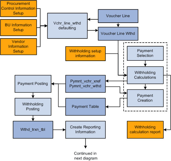

The following diagrams illustrate the general process flow for withholding in PeopleSoft (the withholding process for your location may differ slightly).
Withholding process flow (part 1)

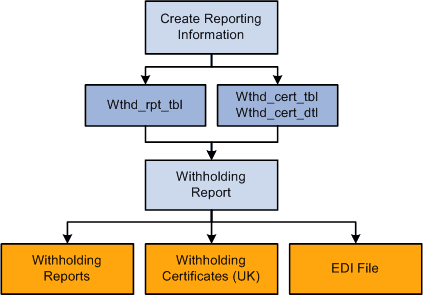

The following diagrams illustrate the general process flow for withholding in PeopleSoft (part 2).
Withholding process flow (part 2)
You complete the withholding process as follows:
  1. Set up your withholding environment.
    Set up the appropriate withholding rules, classes, types, jurisdictions, and entities. Under the withholding entity, define the withholding remit supplier or suppliers, assign the combination of withholding types, jurisdictions, classes, and rules that apply, and define the type of control information required from the supplier to process the withholding. You apply combinations of withholding entities, types, jurisdictions, classes, and rules to your withholding suppliers when you define them. You can assign more than one combination to a supplier. For example, a U.S. Supplier may be subject to both 1099–G and 1099–MISC withholding.
    You can also define withholding codes, which you can use to override the withholding information that defaults onto the voucher from the supplier; these, too, are combinations of withholding entities, types, jurisdictions, and classes.
    As a final step, set up the withholding reports to meet your reporting requirements.
  2. Enter withholding suppliers.
    Make any supplier a withholding supplier by selecting the Withholding check box on the Supplier Information - Identifying Information page, and by transferring to the Withholding Supplier Information page from the Supplier Information - Location page, on which you select the appropriate withholding entities and enter the associated withholding control information.
  3. Enter withholding vouchers.
    The type of withholding that you define for the supplier defaults to each voucher line. Therefore, any vouchers you enter for a supplier that you have defined as a withholding supplier are subject to withholding. If the voucher is for a withholding supplier, you can click the Withholding link on the Voucher - Invoice Information page to access the Withholding Information page, where you can view the withholding for each voucher line and make the lines not withholding applicable, or make adjustments as needed.
  4. Pay the vouchers.
    Depending on your withholding setup, the system may generate a separate withholding payment to the tax authority when the voucher is paid, or just calculate the withholding for reporting to the tax authority. During payment posting, a liability is created for the withholding portion. As you pay the withholding portion, the liability is reduced based on your general ledger setup.

  5. Post the withholding.
    Posting combines voucher and payment information into transaction tables.
  6. View withholding balances online.
  7. Complete the required set up for generating your withholding reports by entering your withholding control information and running a withholding control report.
    Once you have completed these steps you can run your withholding reports based on the requirements of your tax authority.
