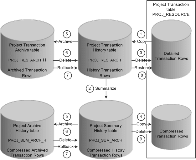

Archive Process Flow
This diagram illustrates how the archive process follows the data compression process, which consists of nine steps.
The project data compression process is followed by the archive process
The data compression, archiving, and restoration process flow that the system performs is:
  1. Copy the detailed transaction rows based on the compression template and run control options from the Project Transaction table (PROJ_RESOURCE) to the Project Transaction History table (PROJ_RES_ARCH).
  2. Summarize detailed transaction rows in the Project Transaction History table and copy them to the Project Summary History table (PROJ_SUM_ARCH).
  3. Delete the original transactions from the Project Transaction table.
  4. Copy summarized transactions in the Project Summary History table to the Project Transaction table.
  5. Archive or copy rows from the Project Transaction History table to the Project Transaction Archive table, and from the Project Summary History table to the Project Archive History table.
  6. Delete archived rows in the Project Transaction History table and in the Project Summary History table.
  7. Roll back archived rows from the Project Transaction Archive table to the Project Transaction History table, and from the Project Archive History table to the Project Summary History table.
  8. Restore rows from the Project Transaction History table to the Project Transaction table as detailed rows.
  9. Delete compressed rows in the Project Transaction table.
