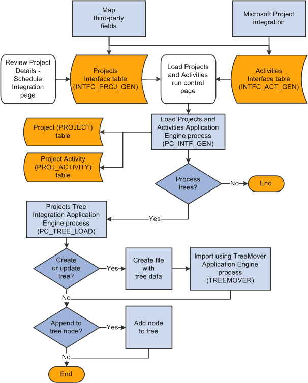

The Load Projects and Activities process invokes the Projects Tree Integration Application Engine process (PC_TREE_LOAD). Use the Projects Tree Integration process to:
  • Create or update a project tree by using the PROJECT_BU structure ID.
  • Append a project to a tree node.
This diagram shows the table and the steps for loading the tree during the Load Projects and Activities process:
Load Projects and Activities process table and steps to load tree
