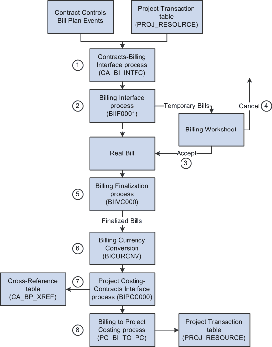

Understanding the Billing Process Flow
The subsequent billing cycle diagram shows the flow of the billing process for rate-based contract lines. The numbered steps that are on the diagram correspond to updates that occur to these tables:
  • PeopleSoft Contracts control tables—Billing Plans (CA_BILL_PLAN) and Billing Events (CA_BP_EVENTS).
    The Billing Plans table defines high-level information about the billing plan. The Billing Events table defines when payments are due.
  • Contracts-Billing Cross-reference table (CA_BP_XREF).
    The Contracts-Billing Cross-reference table provides visibility of all billing activity that relates to contracts, regardless of where the billing activity originates.
  • Project Transaction table (PROJ_RESOURCE).
The numbered steps are discussed in more detail in the following diagram:
This diagram illustrates the billing cycle flow for rate-based contract lines.
Billing cycle for rate-based contract lines
