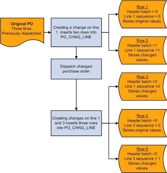

  1. You dispatch a purchase order containing three lines.
  2. You create a change on line 1.
    The header change order batch number is set to 1; the change sequence number for the first line is also 1.
    A historical row is created to store original values for line 1. The header change order batch number is 0 and change sequence number for the first line is 0.
  3. After you dispatch the first batch of changes (change order batch number 1), you change lines 1 and 3.
    • The change order batch number is 2, because you are making changes after dispatching change order number 1.
    • Because this is the second time that you have changed line 1, its change sequence is 2.
    • Because you have changed line 3 for the first time, its change sequence is 1.
      The system creates a historical row to store original values for line 3. The header change order batch number is 0 and the change sequence number for the first line is 0.
This diagram illustrates how the PO_CHNG_LINE table helps track the batch and sequence changes discussed in the example:
Purchase order change order batch and sequence tracking in PO_CHNG_LINE
