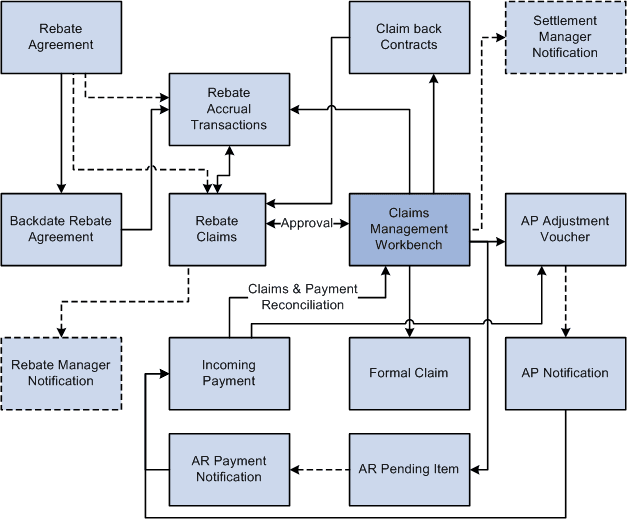

The next diagram depicts the claims management process flow for vendor rebates using the Claims Management workbench. The process includes rebate claim approvals through the Claims Management Workbench and notifications to the rebate manager and settlement manager:
Claims management process flow for Vendor Rebates
Vendor Rebate Claim Process
