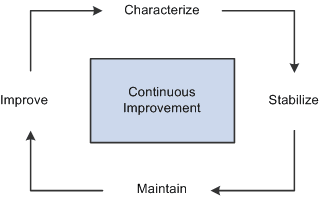

This diagram illustrates how the functions and features within Quality (characterize, stabilize, maintain, and improve) help you meet the requirements within a continuous improvement model:
This diagram illustrates how the functions and features within Quality.
Continuous improvement model
This model incorporates four main continuous activities. Each activity validates the previous activity.
