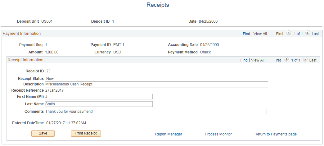

  3. Enter details about the payment on the Regular Deposit - Payments Page (PAYMENT_DATA2) and click the Receipts link. This link is available only when the Deposit Type is miscellaneous receipts and the Journal Directly check box is selected.
  4. On the Receipts page (PAY_RECEIPT_AR), enter receipt information.
    If desired, enter a description, receipt reference, name, and comments regarding the payment.
    Click Save.
    This example illustrates the fields and controls on the Receipts page.
    Receipts page (for miscellaneous cash receipts)
  5. Click the Print Receipt button to generate the receipt.
    BI Publisher processing uses the ARXPRINTRT process to generate the PDF file.
  6. Click the Report Manager link on the Receipts page to view the receipt and print out as needed.
