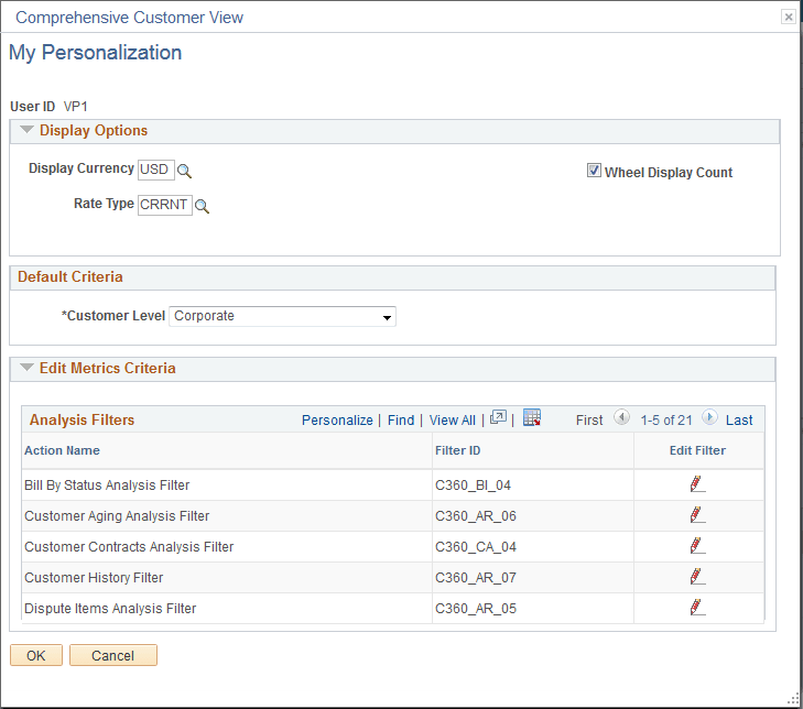

Defining Display Options and Metrics Criteria
Use the My Personalization page to customize user-level display options and pagelet metrics criteria.
Navigation:
Click the Actions icon in the Comprehensive Customer View header and select My Personalization.
This example illustrates the fields and controls on the Comprehensive Customer View - My Personalization page.
Term Definition
Wheel Display Count
Select this check box to display the counts in parentheses for transactions on the Transaction Wheel.
Customer Level
Select from these levels:
  • Corporate
  • Correspondence
  • No Relationship
  • Remit From
Analysis Filters
Click the Edit icon for the filter to save new values for displaying data on pagelets that use the selected filter.
You can also access and edit the filter values by clicking the action glyph next to the pagelet title. This is a temporary filter and values are not saved for later use. To save filters, edit the filters on the My Personalization page.
