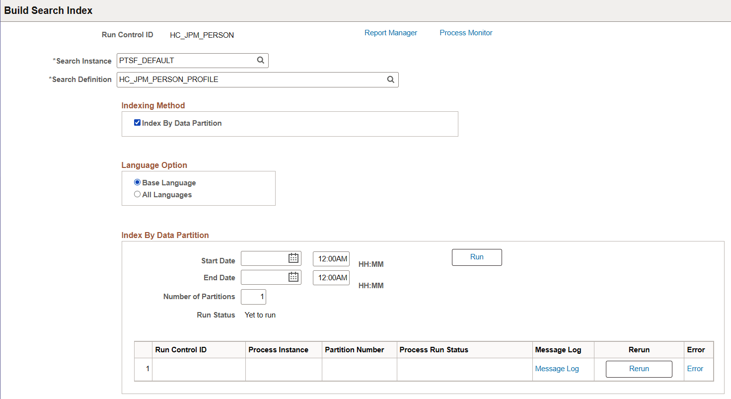

This example illustrates the fields and controls on the Build Search Index page when a search definition is selected that is enabled for data partitioning.
From the Build Search Index run control page:
  1. Assign a Run Control ID that reflects the index you are building.
    If more than one user is building a particular index, each person must create their own run control.
  2. Select a search definition that is enabled for data partitioning.
    These application-specific search definitions are enabled for data partitioning:
    Application Search Definition
    Job Profiles
    HC_JPM_NONPERSON_PROFILE
    Person Profiles
    HC_JPM_PERSON_PROFILE
  3. Select Index By Data Partition, which is only available for high-volume search definitions.
    Oracle PeopleSoft does not recommend that you select the Index by Date Range Indexing Method.
  4. In the Index By Data Partition section, enter a start and end date to select data from that range.
    You do not have to select all of your data using these dates. When using multiple run controls, you can select data in chunks, index that set using partitions, and then select a different date range. Oracle recommends that you index your most recent data first so that you can get your search definition working. Then index earlier data. Indexing by data partition is additive, meaning, it always adds more data to your index incrementally.
  5. Enter a number in the Number of Partitions field, to specify how the system should split the data based on the entered date range.
    The system chunks the data into equal partitions.
