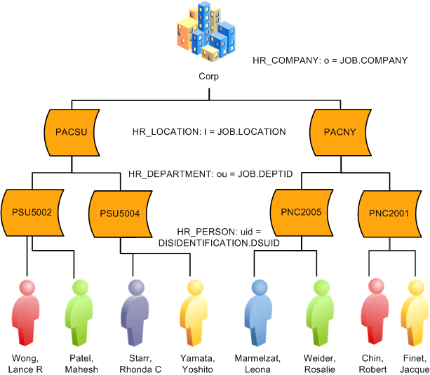

We developed the sample mappings assuming that you are using the tree structure illustrated below, which is HR_PERSONs reporting to HR_DEPARTMENT, the departments are associated to the HR_LOCATION, which report to the corporate level, or HR_COMPANY:
Sample Directory Interface tree
PeopleSoft delivers HR_LOCATION, HR_DEPARTMENT, and HR_PERSON as sample mappings
