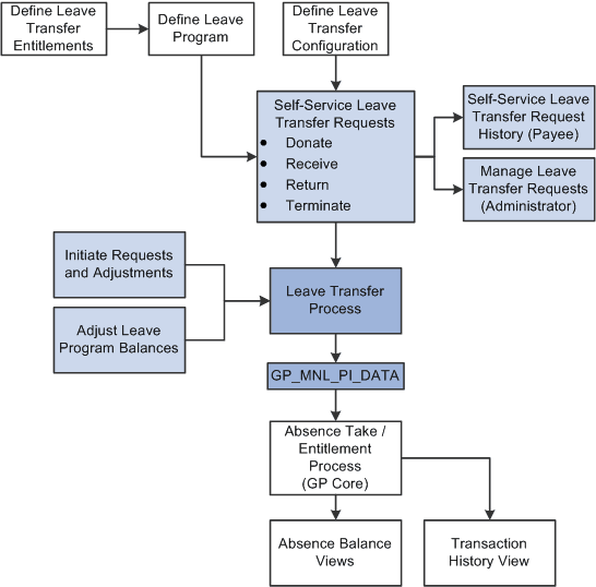

Managing leave transfer request programs consists of four major functions:
Program definition and page configurations.
Employee self service requests to donate leave, request leave, terminate participation, return unused leave, and view a request history.
Administrative actions that define program recipients, manage and approve employee self-service requests, adjust program bank balances, initiate payee requests and adjustments, and view transaction histories.
The Leave Transfer Process (GP_ABSLVDNPI ) Application Engine program processes all of the employee and administrator requests and inserts input data for Global Payroll core processing.
This diagram illustrates the process flow and relationship of the pages used to configure and manage the leave transfer request process.
