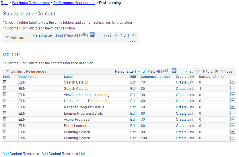

  8. Change all of Learning CREFs node from ELM (default value) to the ELM local node name you updated earlier in the HCM system.
    1. Navigate to PeopleTools, and then Portal, and then Structure and Content.
    2. On the Structure and Content page that appears, click the Workforce Development link.
      On the next screen of the page, click the Performance Management link.
      On the next screen of the page, click the ELM Learning link.
      This example displays the Structure and Content page.
      (Perform this task on all entries listed in the Content References section) Click the Edit link and change the current node name to your actual ELM node in the URL Information section on the Content Ref Administration page. Save the change.
