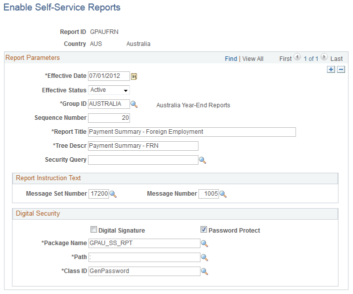

Enabling Self-Service Reports
To enable self service reporting, the administrator creates a Report ID via the Enable Self-Service Report page. To link the report to a report group, you need to map the Report ID to the Group ID. You can map multiple reports to a report group.
This example illustrates the fields and controls on the Enable Self-Service Reports page.
Enable Self Service Reports page
The Digital Security group box is currently not applicable to Global Payroll for Australia.
To know more about enabling self service reports, see Application Fundamentals: Enable Self-Service Reports Page.

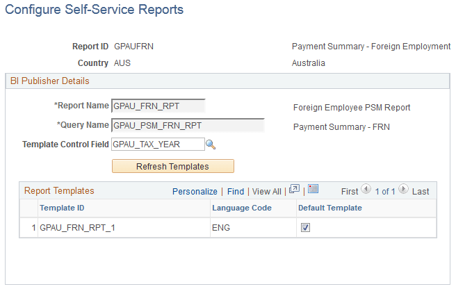

Configuring Self Service Reports
The administrator maps the existing reports developed in BI Publisher to the Report IDs. For this, the report to be mapped to a Report ID must be available in BI Publisher. The two key items required from BI Publisher are:
  • Report Name: All reports created by the report developer using BI Publisher has an unique identifier and key to map Report IDs and Reports. These reports have multiple report templates on to which data is populated. These report templates are effective-dated.
  • Query Name: Every report runs SQL queries that retrieve data from the database. There are multiple parameters passed to these queries to retrieve the right set of data required to be displayed in the report. These parameters are either dynamically fetched by system or are inputs provided by employee on the self-service portal. These queries are named.
Reports created using BI Publisher are mapped to Report IDs. The administrator can search and select from a list of existing Report IDs and define the parameters.
This example illustrates the fields and controls on the Configure Self-Service Reports page.
Configure Self Service Reports page
To know more about configuring self service reports, see Application Fundamentals: Configure Self-Service Reports Page.

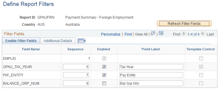

Defining Report Filters
Report Filters are parameters that are passed to an SQL query to fetch data to populate the report template. These parameters can either be dynamically passed or can be taken as an input from an employee through the self-service portal. The parameters that are passed as input by the employee are defined using the Define Report Filters page. The administrator searches and selects from a list of existing Report IDs and define the report filter parameters
This example illustrates the fields and controls on the Define Report Filters page.
To know more about defining report filters, see Application Fundamentals: Define Report Filters Page.
