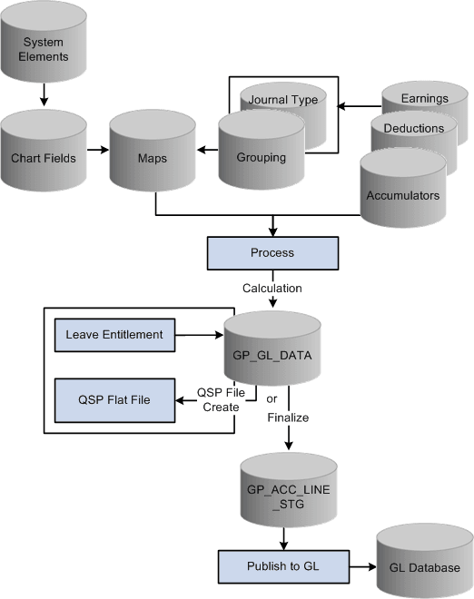

The Global Payroll results integration point uses PeopleSoft Integration Broker to send payroll results to the Global Payroll Accounting Line Stage Record (GP_ACC_LINE_STG). The data is sent using the General Ledger Transaction Prep application engine process (GP_GL_PREP), and uses the Post Global Payroll to General Ledger batch rule (GP_POST_GL).
After Global Payroll sends the data, General Ledger can receive the data and incorporate it into its own data.

This diagram represents the processing of payroll data for the GLI or QSP. The two shaded boxes with borders show the added local functionality. Note that the Leave Entitlement option adds data to the GP_GL_DATA table for inclusion in the output to either QSP or GLI:
Processing of payroll data for GLI or QSP
