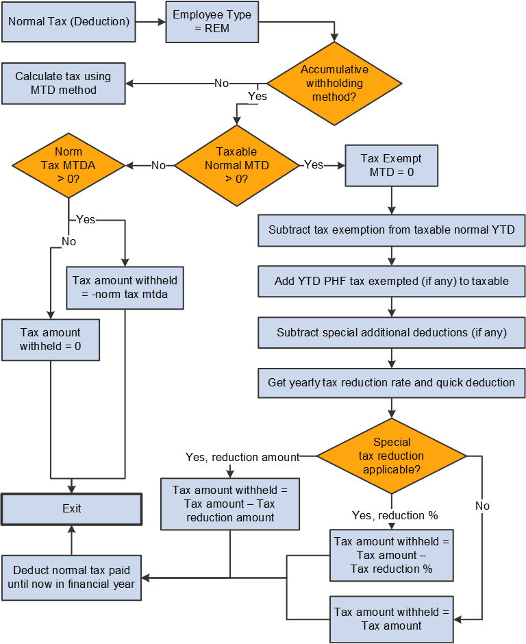

This diagram illustrates the flow of normal tax calculation:
This diagram illustrates the flow of normal tax calculation.
Normal tax calculation
The NORM TAX deduction invokes the formula CN FM CALC NMYR TX, which derives normal tax from calculated normal salary. The formula references bracket CN BR TX EXEMPTION to load the tax exemption amount according to the employee type CN VR EE TYPE. It also calls formula CN FM CALC YR TAX to calculate tax.
If the variable CN VR BONUS TX IND is set to Y, the system calculates tax for both annual bonus and normal salary together using the formula CN FM CALC NMYR TX.
See Also Annual Bonus Tax Calculation.
The formula CN FM CALC NMYR TX:
  1. Deducts year-to-date monthly tax exemption TAX EXEMPTION YTD from year-to-date monthly taxable income TAXABLE NORMAL YTD to get taxable income.
  2. Calls formula CN FM TAX PHF YTD to calculate year-to-date nontaxable PHF/SI contribution deduction amount and subtracts it from the taxable income, if applicable.
  3. Subtracts year-to-date special additional deduction amounts CN AC SP DED YTD from the taxable income, if applicable.
  4. Calls formula CN FM CALC YR TAX, which:
    1. References the bracket CN BR TAX RATE YR to obtain the tax rate and quick calculation deduction to derive the withholding amount for the payee's normal salary for one pay period in the current financial year.
    2. Subtracts the reduction from the tax withholding amount if the payee is eligible for disability reduction. If a payee override exists, the assumption is that it overrides an amount; otherwise, the formula uses the percent value retrieved from the CN BR TX EXEMPTION bracket.
      Therefore, if an override exists, the tax withheld equals the tax amount from step 4a minus the override amount. If the tax withheld is less than zero, the formula sets the tax to zero. If no override exists, the formula subtracts the reduction percent from the tax withheld from step 4a.
  5. Deducts any normal tax already paid year-to-date.
  6. If TAXABLE NORMAL YTD is less than tax exemption and normal tax exists from earlier segments in the period, makes NORM TAX_MTDA negative to reverse calculated amount. Otherwise, sets NORM TAX_MTDA to 0.
