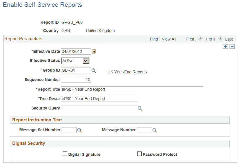

Enabling Self-Service Reports
To enable self service reporting, the administrator creates a Report ID using the Enable Self-Service Report page. To link the report to a report group, you need to map the Report ID to the Group ID. You can map multiple reports to a report group.
Navigation:
Set Up HCM, and then Common Definitions, and then Self-Service Report Framework, and then Enable Self-Service Reports, and then Enable Self-Service Reports
This example illustrates the Enable Self-Service Reports page.
Enable Self-Service Reports Page
To know more about enabling self service reports, see Application Fundamentals: Enable Self-Service Reports Page

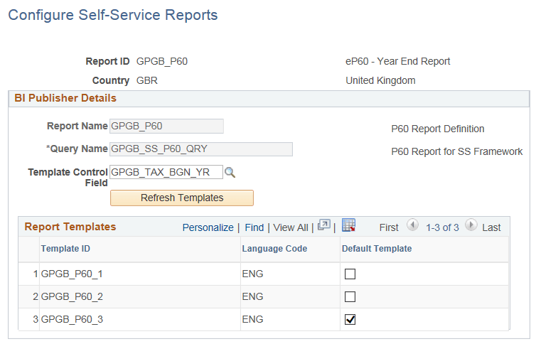

Configuring Self Service Reports
The administrator maps the existing reports developed in BI Publisher to the Report IDs. For this, the report to be mapped to a Report ID must be available in BI Publisher. The two key items required from BI Publisher are:
  • Report Name: All reports created by the report developer using BI Publisher has a unique identifier and key to map Report IDs and Reports.
  • Query Name: Every report runs SQL queries that retrieve data from the database. There are multiple parameters passed to these queries to retrieve the right set of data required to be displayed in the report. These parameters are either dynamically fetched by system or are inputs provided by employee on the self-service portal. These queries are named.
    For example, if you need to create P60 Report:
    Create a new PS query to select data from GPGB_P60_RPT record and filter data. This query will filter data as per following prompts:
    1. Employee Id
    2. Employee Record
    3. Pay Entity
    4. Tax year
    Reports created using BI Publisher are mapped to Report IDs. Here, link the existing BI publisher definition (GPGB_P60) to self-service configuration. The administrator can search and select from a list of existing Report IDs and define the parameters.
Navigation:
Set Up HCM, and then Common Definitions, and then Self-Service Report Framework, and then Configure Self-Service Reports, and then Configure Self-Service Reports
This example illustrates the Configure Self-Service Reports page.
Configure Self-Service Reports Page
To know more about configuring self service reports, see Application Fundamentals: Configure Self-Service Reports Page

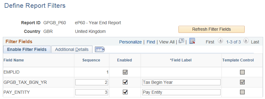

Defining Report Filters
Report Filters are parameters that are passed to an SQL query to fetch data to populate the report template. These parameters can either be dynamically passed or can be taken as an input from an employee through the self-service portal. Using the Define Report Filters page, the employees can define the input parameters. The administrator searches and selects from a list of existing Report IDs and define the report filter parameters.
Navigation:
Set Up HCM, and then Common Definitions, and then Self-Service Report Framework, and then Self-Service Report Filters, and then Define Report Filters
This example illustrates the Define Report Filters page.

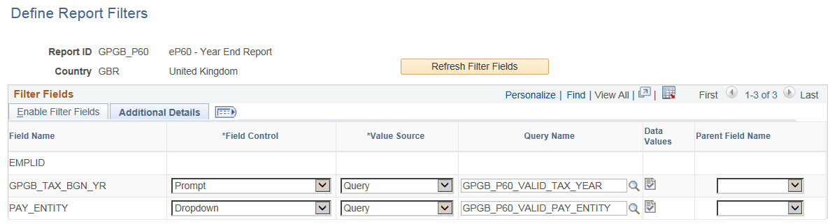

Here, select the Tax Year as a template control field and configure the filter fields from the setup to enable Tax Year and Pay Entity.
This example illustrates the Define Report Filters_Additional Details page.
Define Report Filters page_2
To know more about defining report filters, see Application Fundamentals: Define Report Filters Page
