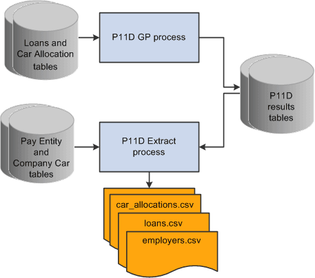

This diagram shows how the Global Payroll for the UK provides a P11D data extract tool that enables you to extract the P11D information that is stored in the standard PeopleSoft HR tables and creates extract files in a CSV format that can be processed by a third-party P11D solution:

When you have successfully run the payroll process, run the Extract P11D Data Application Engine process (GPGB_P11D). This process:
  • Extracts P11D information from various PeopleSoft tables.
    The process extracts data from the P11D result tables, previously populated by the P11D global payroll process, and other HR tables.
  • Generates a series of CSV files using the extracted data.
    The resulting CSV files are stored in the report repository.
The Extract P11D Data process uses the extract definition, which you define for your P11D solution, to determine the data extracted and the format of the CSV file.
Set up extract definitions using the Define P11D Solution GBR (GPGB_P11D_SOLUTION) component.
See Understanding P11D Extraction Setup.
This diagram summarizes the two processes that comprise the P11D data extract tool:
Summary of P11D Data Extract Processes
The diagram shows an example of the extract files only. The CSV files produced differ according to the third-party P11D solution you are using.
Global Payroll for the UK delivers an extract definition that works with the KPMG P11D Solutions 2004 application, but this is provided as an example only. You can create extract definitions and modify the delivered elements for your own P11D solution.
