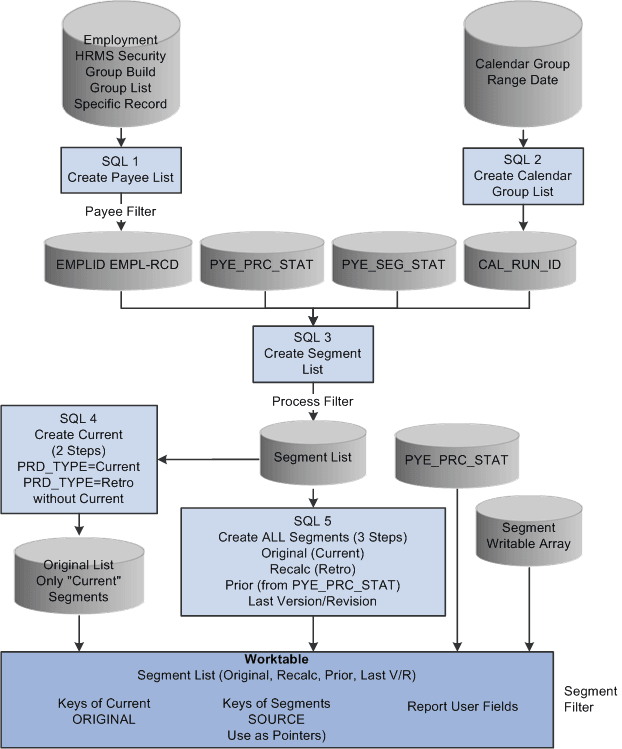

  1. Select calendar groups.
  2. Select eligible payees using payee lists, group builds, security, and payee filter. If a payee filter was created, it is applied here.
  3. Join the payee process status table (GP_PYE_PRC_STAT) and the payee segment status table (GP_PYE_SEG_STAT).
  4. Select the original segments. If a process filter was created it is applied here.
  5. Insert the original, recalc, prior, and last version/revision segments into the worktable (GP_RPTW_TMP). The worktable now contains rows by payee for selected segments, recalculations, prior segments, and last version/revision segments. If a segment filter was created it is applied here.

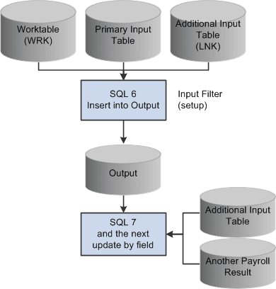

  6. Join the worktable, the primary input table, and the link table (the additional input table joined with the primary input table) according to the data on the Report Data Process Details page. The results are posted to the output table. Only the results derived from the worktable or the primary input table are populated. If an input filter was created it is applied here.
  7. Update the output table with data from the additional input tables.
This diagram illustrates how the system generates the report data Worktable.
Overview of Generating Report Data 1
This diagram illustrates how the system combines the data in the Worktable with the data from the Primary Input Table and Additional Input Table in the process of generating report data.
Overview of Generating Report Data 2
