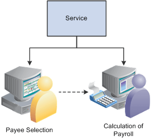

When you run a payroll or absence batch process, the first program that the system calls is the Service program. The Service program acts as the coordinator between the selection of payees to be processed and the calculation process. The Service program initiates the payee selection process. Once the payees are selected, the Service program passes control of the data that was created during the payee selection phase to the Calculation program.
This diagram shows how the Service program coordinates the payee selection and calculation phases.
The Service program is the batch processing starting point
