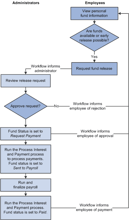

Processing Fund Release Requests
Profit-sharing agreements do not allow for automatic payment of funds, except where the fund amount is below a defined threshold (the variable KFIMMED stores this threshold value). If an employee's fund amount is above the threshold, the employee must submit a request for fund release. These requests are reviewed and approved by the compensation administrator.
Employees can submit fund release requests only after the reference period status is Approved.
Fund release requests only apply to agreements with Company Investment selected as the investment method. Fund releases for other types of investment are managed outside the system.
This illustration shows how fund releases are processed and when workflow is triggered:
Fund release process flow
Fund release request process
