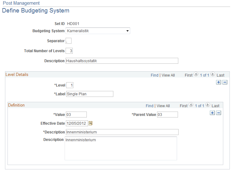

Post Management – Define Budgeting System Page
Use the Post Management – Define Budgeting System page (GPS_BDG_SYSTEM) to set up the budgeting system to be used for post management.
Navigation:
Set Up HCM, and then Product Related, and then Workforce Administration, and then Workforce Data GPS, and then Post Management, and then Budget System, and then Post Management – Define Budgeting System
This example illustrates the fields and controls on the Post Management – Define Budgeting System page.
A budgeting system allows customers to associate a post plan to a budgeting unit. Budgeting systems that are commonly used in German public agencies include Kameralistik and Doppik.
The system supports the setup of these budgeting systems: Kameralistik, Doppik and Other.
For example, the system delivers four levels for Doppik:
  1. Product Area
  2. Product Group
  3. Product
  4. Account
For Kameralistik, these levels are delivered:
  1. Single Plan
  2. Chapter
  3. Title
The Other option allows you to define your own budgeting unit, which can support up to five levels.
When creating your own budgeting system, be aware that:
  1. For the first (root) level, the value and parent value specified for each definition (node) must be the same.
  2. For the last level, All can be used as the parent value. It means that the definition (with All as parent value) is valid for all nodes in the second to last level.
Field or Control Description
Label
Displays the field label to be used for the corresponding level in all post management PIA pages, for example, in post plan search pages, or the header area where a post plan is being viewed or modified.

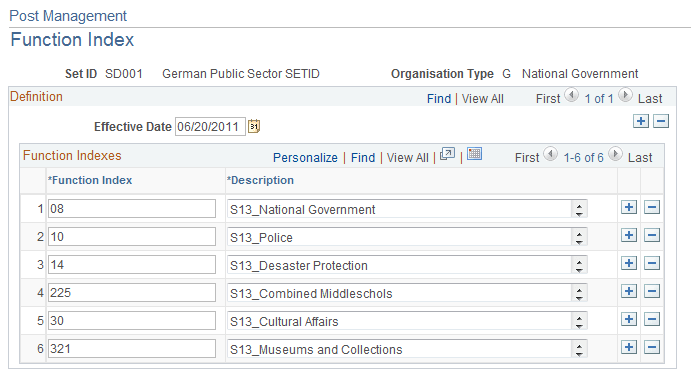

Post Management – Function Index Page
Use the Post Management – Function Index page (GPS_FUNCTION_INDEX) to define function indexes.
Navigation:
Set Up HCM, and then Product Related, and then Workforce Administration, and then Workforce Data GPS, and then Post Management, and then Function Index, and then Post Management – Function Index
This example illustrates the fields and controls on the Post Management – Function Index page.
Post Management - Function Index page
Function index is an attribute of a post plan and it is used mainly for reporting purposes. Function indexes can be defined for each setID and organization type combination in the system.

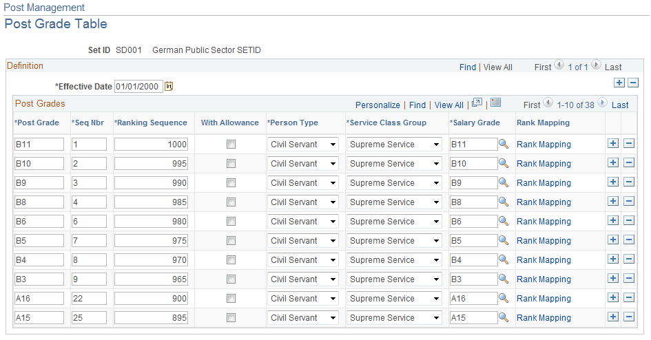

Post Management – Post Grade Table Page
Use the Post Management – Post Grade Table page (GPS_GRADE_TABLE) to define post grades and their associations with salary grades.
Navigation:
Set Up HCM, and then Product Related, and then Workforce Administration, and then Workforce Data GPS, and then Post Management, and then Post Grade Table, and then Post Management – Post Grade Table
This example illustrates the fields and controls on the Post Management – Post Grade Table page.
Post Management - Post Grade Table page
Post grade is referenced in post plan rows to show the grade of a post upon which some action will be taken during the corresponding post plan year. It is a combination of HR grade, person type, service class group and allowance. Define all grades (civil service or public sector employee) that are used in post management on this page.
Seq Nbr (sequence number)
Enter a sequence number, which is used to define sorting orders in prompts and on search results.
Ranking Sequence
Enter a ranking for the post grade, as one grade may be equal to or higher than another grade. It is used to identify what grade is of lower or higher value when performing decrements or increments.
The administrator uses this information in his or her staffing decisions. He or she may staff a post with an employee whose grade is lower than the post grade, in which case, the actual cost will be lower than the budgeting cost.
With Allowance
Select if the post is suitable for a civil servant or employee who collects allowance (not family or child allowance).
Person Type
Specify if the post grade is created for civil servant or employee.
Service Class Group
Specify a service class group for the post grade. Values are:
Simple Service
Midrange Service
Upper Service
Supreme Service
Without University Degree
With University Degree
Salary Grade
Specify a salary grade for the post grade. Field values come from the salary plan component of the same setID in HR Core.
Rank Mapping
Click to access the Civil Service Rank Mapping page (GPS_RANK_MAP_SBP) and enter equivalent civil service ranks for the post grade. In German Public Sector, one grade can be associated with different civil service ranks.
Civil service ranks are defined using the Civil Service Ranks page (GPS_CSR_CODES).

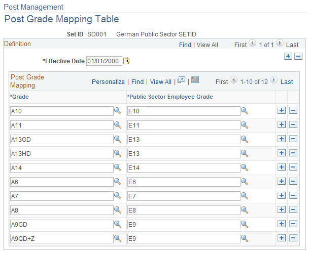

Post Management – Post Grade Mapping Table Page
Use the Post Management – Post Grade Mapping Table page (GPS_GRADE_MAP) to create mapping between post grades (for civil servant) and public service employee grades.
Navigation:
Set Up HCM, and then Product Related, and then Workforce Administration, and then Workforce Data GPS, and then Post Management, and then Post Grade Mapping, and then Post Management – Post Grade Mapping Table
This example illustrates the fields and controls on the Post Management – Post Grade Mapping Table page.
Post Management - Post Grade Mapping Table page
Use this page to provide mapping between civil service grades and public sector employee grades.
When administrators staff posts, they can fill civil service positions with public sector employees in grades that are equivalent to the grades listed on civil servant posts.
Both civil servant and public sector employee grades are defined using the Post Grade Table page.

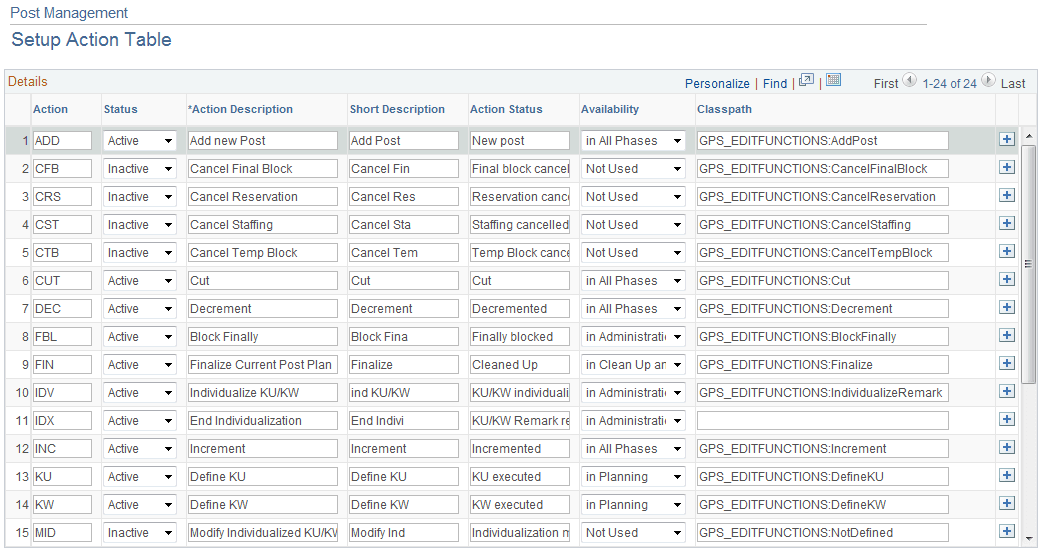

Post Management – Setup Action Table Page
Use the Post Management – Setup Action Table page (GPS_ACTION_TBL) to specify actions that can be performed on post plans.
Navigation:
Set Up HCM, and then Product Related, and then Workforce Administration, and then Workforce Data GPS, and then Post Management, and then Action Table Setup, and then Post Management – Setup Action Table
This example illustrates the fields and controls on the Post Management – Setup Action Table page.
Post Management - Setup Action Table page
This page lists all the actions that can be performed on post plans at different post management phases. It identifies the code that must be processed when a particular edit function was selected by the user.
Do not change existing information on this page other than the action description and short description. Additional actions can be added to the page if coded as a customization.
Action
Displays the key code that is used in PeopleCode to identify the application class that needs to process for the corresponding action.
Action Description
Displays the text that is used as the field value in the Edit Function field.
Action Status
Displays the text that is used as the Action field value for posts after the action is performed.
Availability
Displays the phase in which the edit function is available. This can be Planning, Admin, Clean Up, or All (all three phases).
Classpath
Displays the path to the application class that is used to find the method required for the corresponding action.
