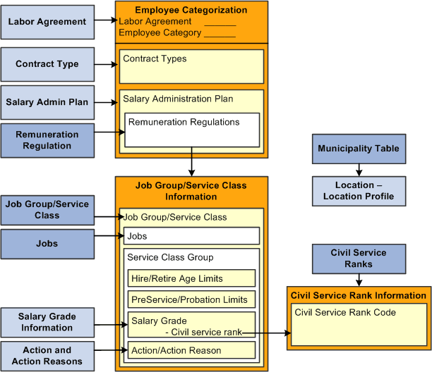

Before you can perform business processes specific to German Public Sector (GPS), you must establish GPS-specific system parameters that define basic operational rules and drive the software package. This diagram shows the various components you will use to set up and map the GPS tables:
Diagram showing various components used to set up and map the GPS tables.

  3. Map employee category information that will be used for validation.
    1. Map contracts, salary plans, and remuneration regulations to your employee categories using the Employee Categorization component.
    2. Associate job group/service classes to the remuneration regulations on the Job Group/Service Class Information page. Then link jobs, service class groups, age and other limits for validation, salary grades, and action information to your job group/service classes.
    3. Link civil service rank codes to your salary grades on the Civil Service Rank Information page.
