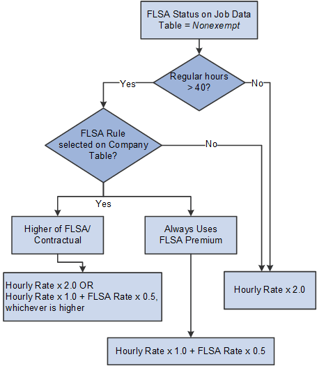

This diagram illustrates how the system calculates double-time based on options that are set on the Job Data Table, the Company Table, and the Alternative Overtime State Table.
Calculations for FLSA status of Non-Exempt on the Job Table
For FLSA nonexempt employees, the system considers the FLSA rule specified on the Company Table (Default Settings page).
  • If the FLSA Required check box is selected and Higher of FLSA/Contractual is specified, then the system compares the amounts calculated for each of these 2 rules and picks the higher of the two:
    Rule 1: Hourly rate times 2.0 for hours over 40.
    Rule 2: Hourly rate times 1.0 (for the straight time portion) plus the FLSA rate times .5 (for the premium portion) for hours over 40.
  • If the FLSA Required check box is selected and Always uses FLSA Premium is specified, then the system calculates the double-time amount as follows for any hours over 40:
    Hourly rate times 1.0 (for the straight time portion) plus the FLSA rate times .5 (for the premium portion).
    The premium portion of the double-time pay is always paid at .5, and not as specified on the earnings table. To ensure the multiplication factor on the earnings table is used in the calculation, the employee must be set up with FLSA Status of ALT OT, and the employee’s work state must be set up in the Alternative Overtime Table.
  • If the FLSA Required check box is not selected, then the system calculates the hourly rate times 2.0 for any hours over 40.
