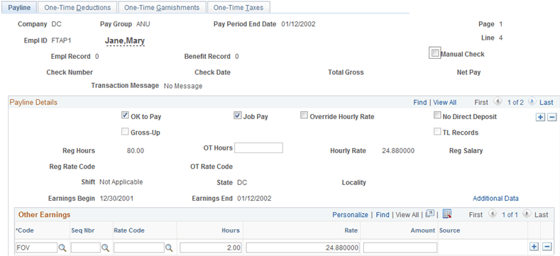

  • Addl Line Nbr 0 with 80 standard hours at the pre-offset hourly rate of $24.88, and 2 overtime hours based on the same hourly rate.

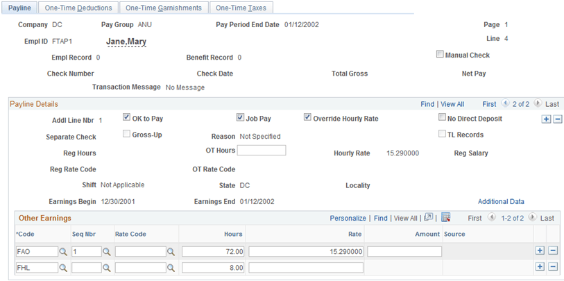

  • Addl Line Nbr 1 with an offset hourly rate of $15.29, earnings code FAO for 72 hours, and FHL (holiday) for 8 hours.
Payline details appear on the Update Paysheets, By Payline page.
Navigation:
Payroll for North America, and then Payroll Processing USF, and then Update Paysheets, and then By Payline, and then Payline
This is an example of a Payline Page, annuitant Addl Line Nbr 0.
Payline page, annuitant Addl Line Nbr 0 example
This is an example of a Payline Page, annuitant Addl Line Nbr 1.
Payline page, annuitant Addl Line Nbr 1 example

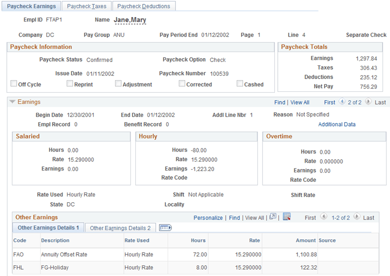

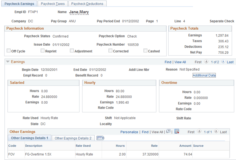

For additional line number 0, Addl Line Nbr field in the Earnings group box is blank.
Paycheck Earnings page, annuitant Addl Line Nbr 0 example
Paycheck Earnings page, annuitant Addl Line Nbr 1 example

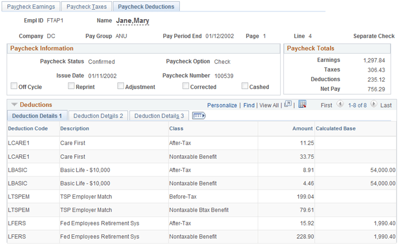

Annuitant Paycheck Deductions
Mary’s premium earnings and her retirement, TSP, and FEGLI contributions are calculated at her full job hourly rate of $24.88. Based on Mary’s earnings, her deductions are as follows:
  • Her before-tax TSP employer match is $199.04 (based on employee withholding of 10% of the special accumulator pre-offset earnings).
  • Her nontaxable TSP employer match is $79.61 (based on employer contribution).
  • Her after-tax retirement (FERS) is $15.92 (based on employee withholding of 0.8% of the special accumulator pre-offset earnings).
  • Her nontaxable retirement (FERS) is $228.90 (based on employer contribution of 11.5% of the special accumulator pre-offset earnings).
  • Her after tax FEGLI is $8.91.
  • Her nontaxable FEGLI is $4.46
Paycheck deduction details appear on the Review Paycheck, Paycheck Deductions page.
Navigation:
Payroll for North America, and then Payroll Processing USF, and then Produce Payroll, and then Review Paycheck, and then Paycheck Deductions
This is an example of a Paycheck Deductions page, showing annuitant retirement deductions.
Paycheck Deductions page, annuitant retirement example
