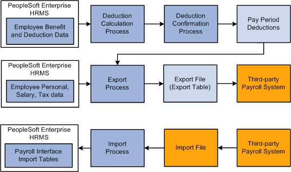

Data Exchanges
Payroll Interface enables you to maintain employee data in PeopleSoft HCM while using the third-party payroll system to perform the payroll processing functions. With Payroll Interface, data exchanges between the two systems are performed in four phases:
  1. (Optional) Run the Calculate Deductions and Deduction Confirmation processes to calculate and confirm pay period deductions.
  2. Run the Export process to retrieve and write the pay (and deduction) data from PeopleSoft HCM to an export file or table.
  3. Make the export file or table available to the third-party payroll vendor. The third-party vendor uses the appropriate software solution to load the data into the third-party payroll system, to perform the payroll processing functions, and to write the processed payroll results to one or more import files.
  4. (Optional) Run the Import process to read the import file and load the processed payroll data back into PeopleSoft HCM.
This diagram illustrates the Payroll Interface Deduction, Export, and Import processes:
This diagram illustrates the Payroll Interface Deduction, Export, and Import processes.
