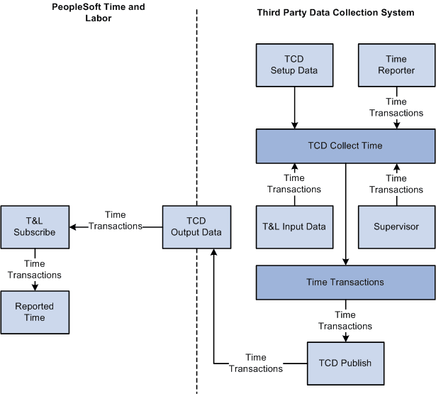

This diagram depicts how Time and Labor collects data from a TCD.
