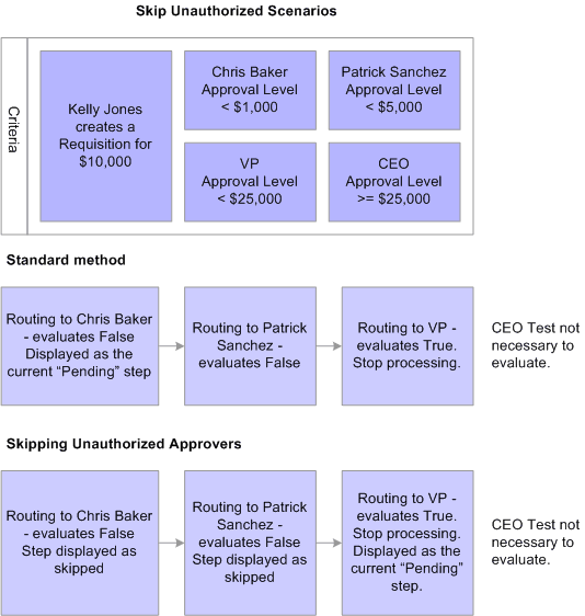

This diagram illustrates an example of a workflow routing setup for the standard method and a workflow routing that skips unauthorized users:
Diagram illustrating an example of a workflow routing setup for the standard method and a workflow routing that skips unauthorized users.
Example of Skip Approval scenario
In the example, the criteria for the workflow approval path is set up for Chris Baker to have approval authority for less than 1,000.00 USD, Patrick Sanchez to have authority for less than 5,000.00 USD, VP to have approval for less than 25,000.00 USD, and CEO to have approval for a requisition equal to or more than 25,000.00 USD.
Kelly Jones creates a requisition for 10,000.00 USD.
If the system is not set up to skip unauthorized users, the system displays Chris Baker, Patrick Sanchez, and the VP as pending steps in the approval path.
If the system is set up to skip unauthorized users, the system displays the approval path with the VP as the only listed approver, and will display Chris Baker and Patrick Sanchez as skipped.
