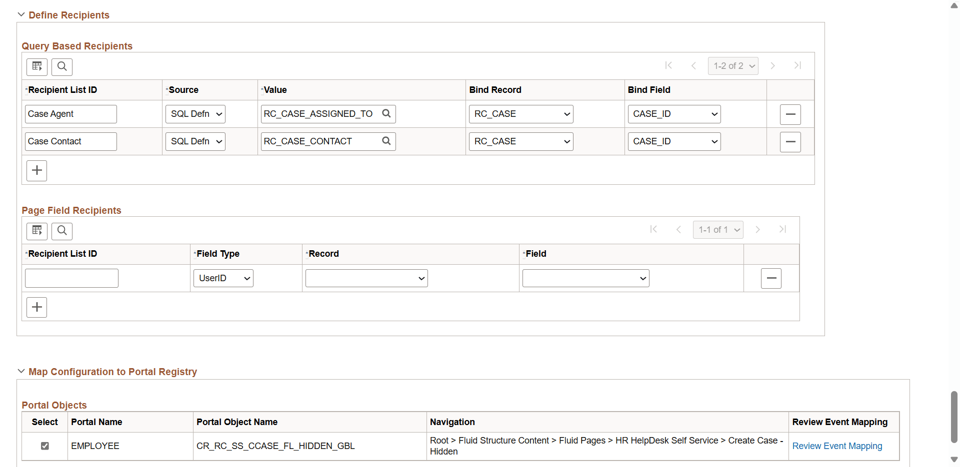

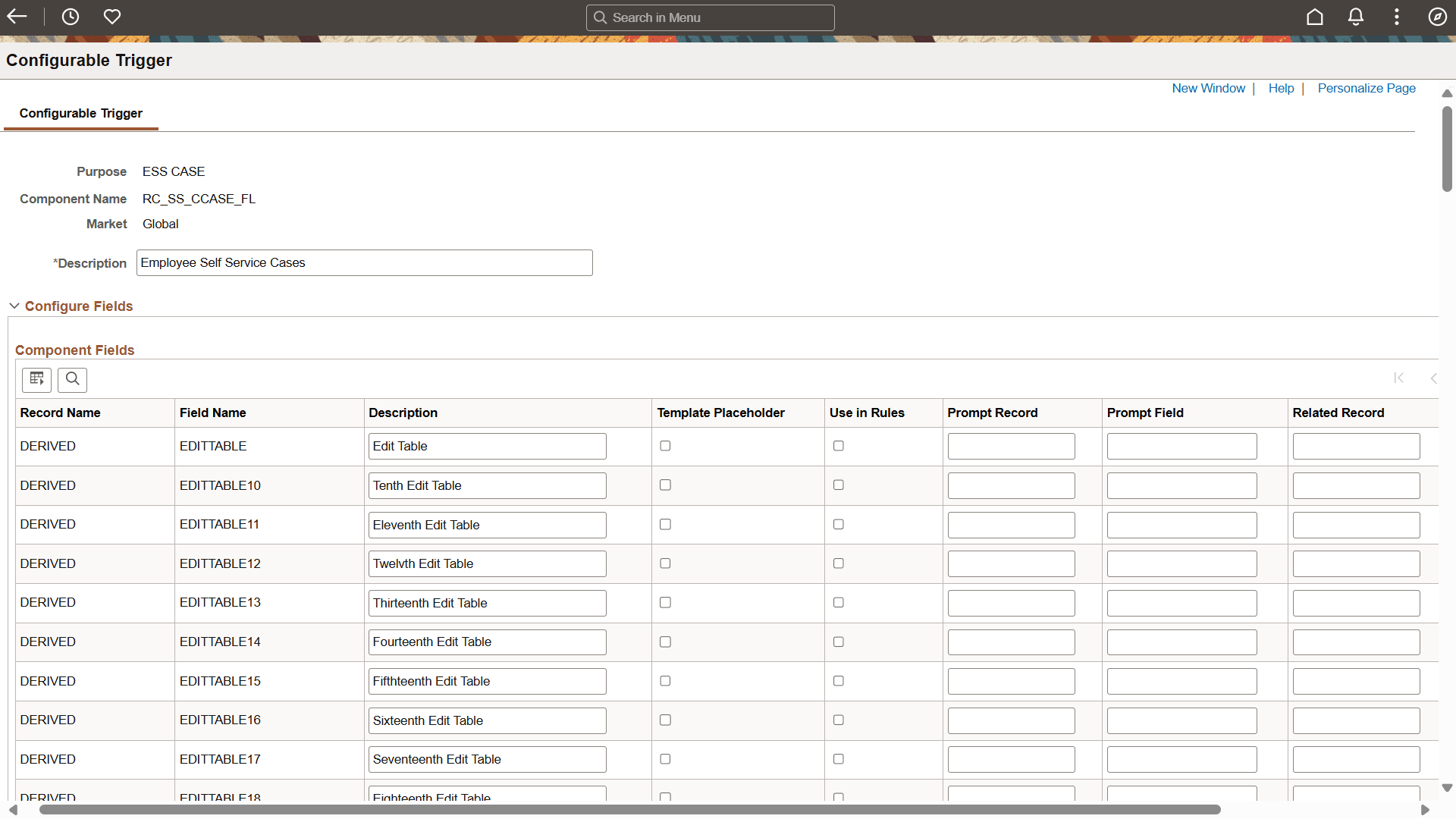

To support questionnaires that are triggered automatically from case pages, the technical administrator needs to create a configurable trigger setup for the self-service Case component in CRM. The configurable trigger setup is later used in creating Application Generated questionnaire events, like the one in this example. Use the Configurable Trigger Page to specify:
  • Fields that can be used as bind variables when composing notifications, as well as in defining triggering conditions in questionnaire events.
  • Recipients of notifications.
  • Application pages from where questionnaires can be triggered automatically.
This screenshot illustrates the Configurable Trigger page where fields can be specified for use in notification templates and triggering conditions.
Configurable Trigger page (1 of 2)
This screenshot illustrates the Configurable Trigger page where recipients are specified and portal registries mapped.
Configurable Trigger page (2 of 2)

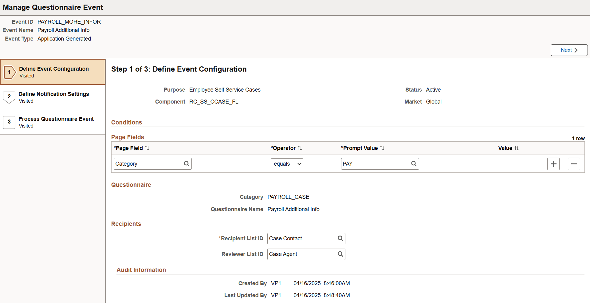

Next, the questionnaire administrator creates a questionnaire event that will trigger a questionnaire automatically when a user submits an HR HelpDesk case that is created for a payroll issue. The user will receive an in-app notification about the questionnaire, requesting additional information for the case.
The type of this questionnaire event is Application Generated. Use the Define Event Configuration Page to specify:
  • The conditions for triggering the questionnaire: Case Category = Payroll
  • The questionnaire to use for the event: Payroll Additional Info
  • Recipients of the notification: Case Contact
  • Reviewer of the notification: Case Agent
This screenshot illustrates the Create Questionnaire Event: Define Event Configuration page where conditions for triggering questionnaires, the questionnaire to be triggered, and recipients are specified.

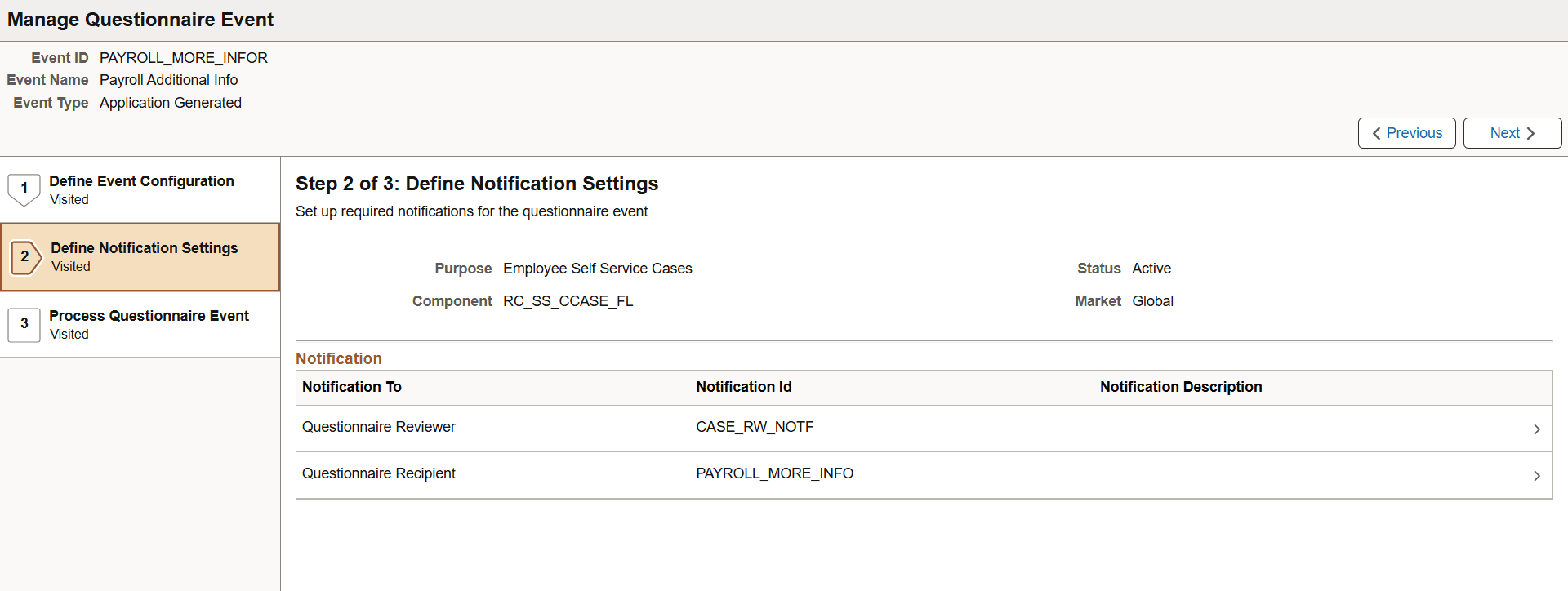

Use the Define Notification Settings Page to select the notification to be used. In this example, notifications come from Notification Composer (notification source = Questionnaire Framework). One for recipients when questionnaires are generated, and the other for reviewers when questionnaires are completed by recipients.
This screenshot illustrates the Create Questionnaire Event: Define Notification Settings page where the notification to be used is specified.

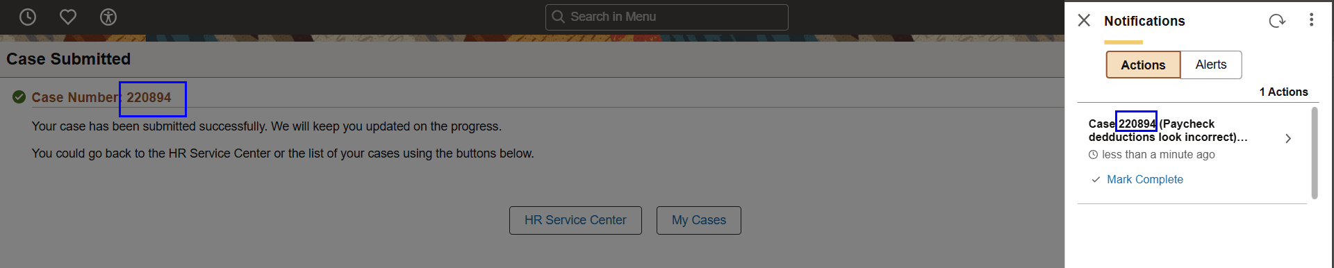

After the case is saved and submitted, the condition of the questionnaire event (case category = Payroll) is met, triggering a questionnaire. An in-app alert appears, notifying the employee (case contact) that a questionnaire related to the HR HelpDesk case is available for the employee to complete.
This screenshot illustrates the in-app notification alert for the questionnaire when the case is saved.
In-app notification for a questionnaire triggered when the case is saved

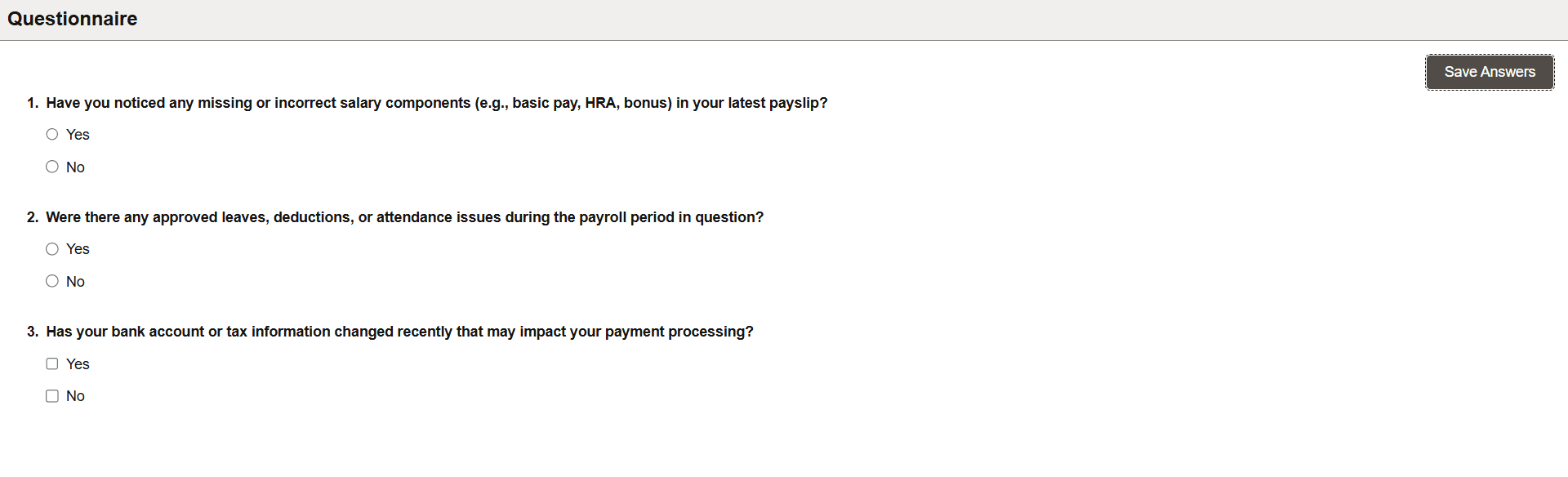

Selecting the in-app notification opens the questionnaire.
Based on the setup, the case agent will receive a notification when the questionnaire has been completed by the employee.
This screenshot illustrates the questionnaire after selecting the in-app notification.
View the questionnaire after selecting the in-app notification

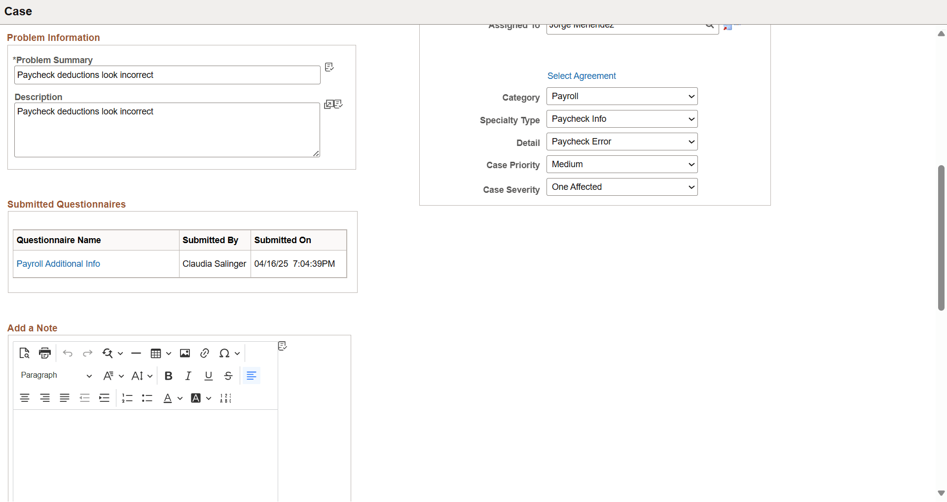

Completed questionnaires can also be viewed from associated cases, if a subpage for displaying questionnaires is added to the Case component. In this example, users can review questionnaires completed for the case in the Submitted Questionnaires section of the Case Details page.
This screenshot illustrates the Case Details page where the case agent can review the questionnaire completed by the employee.
Access the questionnaire on from the associated case
