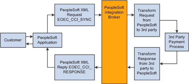

You can use PeopleSoft Integration Broker to process your PeopleSoft credit card transactions with the third-party credit card processing vendor of your choice. Oracle delivers messages and a synchronous service for you to use to set up a synchronous connection with your third-party vendor. Because each third-party vendor requires a different format for communication, PeopleSoft applications do not deliver transformations to your third-party vendor. This is because each third-party vendor has different requirements for inputs and outputs to their services. Therefore, part of setting up an integration involves writing your own transformation programs for the request and response message. The transformation programs are a mapping between the fields in the PeopleSoft system and the fields in your third-party vendor’s service. You also need to set up a node in the PeopleSoft application to process the response from your third-party vendor.
Oracle delivers XML messages for use with XML-based credit card processing vendors. You must build your own XML message transformation into the format that the vendor is expecting.
You can use PeopleSoft Application Engine to perform your transformations. You use the delivered EOEC_CCI_SYNC message for the request transaction and the delivered EOEC_CCI_RESPONSE message for the response transaction. The messages are detailed later in this section.
If you have upgraded from a PeopleTools 8.47 or earlier release, the upgrade program creates service operations for these messages. The service operation names and message names are the same.
The diagram shows the process flow for integration with a third-party credit processing vendor.
EOEC_CCI_Sync Message
The EOEC_CCI_SYNC message is a synchronous request that the credit card interface sends to the third-party vendor. The request can be for an authorize, bill, authorize and bill, credit transaction, or authorization reversal. The PeopleCode that supports this message is located in App Package EOEC_CCI. The following tables describe the request fields and how they are populated by the PeopleSoft system.

When writing your transformation program, use the alias name to reference the fields. When you view the “Request — Original” text of the message, the alias name is displayed.
EOEC_CCI_RESPONSE Message
The EOEC_CCI_RESPONSE message is a response to the request that the credit card interface receives from the third-party vendor. Your transformation should populate the response message fields as shown in the tables.
