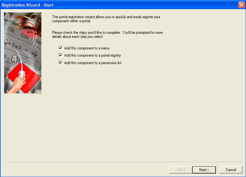

    The Start screen of the Registration Wizard provides the option of adding the component to a menu, a portal registry, a permission list, or a combination of the three. If the component is new and you are running the wizard for the first time, you should select all three options. If you have already run the wizard on this particular component and just need to add it to an additional permission list or portal, deselect the other option, Add this component to a menu.
    This example illustrates the fields and controls on the Registration Wizard - Start dialog box. You can find definitions for the fields and controls later on this page.

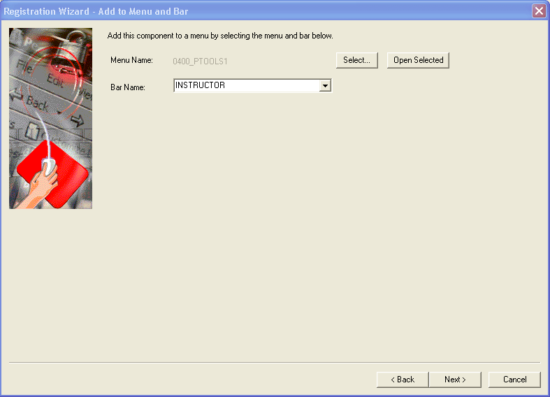

    If you selected to add the component to a menu, then the next screen, Add to Menu and Bar, opens.
    This example illustrates the fields and controls on the Registration Wizard - Add to Menu and Bar dialog box. You can find definitions for the fields and controls later on this page.
  4. Click the Select button to find the menu name, click the Bar Name drop-down list box to assign the bar name, and then click the Next button.
    These names are not exposed to users, but they are required for internal location purposes. Click the Open Selected button to open the menu that you selected in PeopleSoft Application Designer. To view the menu definition without closing the wizard, drag the Registration Wizard to the side.

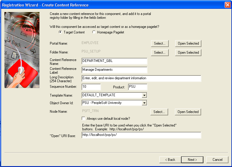

  5. On the Create Content Reference page, select Target Content or Homepage Pagelet.
    If the component is a standard transaction, register it as Target Content.
    This example illustrates the fields and controls on the Registration Wizard - Create Content Reference dialog box. You can find definitions for the fields and controls later on this page.
  6. Complete all fields in the Create Content Reference page.
    Field or Control Description
    Target Content
    Select this check box to register all forms of target content (excluding the homepage).
    Homepage Pagelet
    Select to register a new homepage pagelet. The system applies the homepage template automatically.
    Portal Name and Folder Name
    Click the Select button to change the portal or folder name. Click the Open Selected button to launch a browser that will take you to the administration page to create a new folder, if necessary. The default values are the last ones referenced by the wizard.
    Content Reference Name
    The name is automatically generated, including the market code as the suffix.
    Content Reference Label
    Enter the name of the CREF hyperlink that the user sees as the registry entry.
    Long Description
    Enter hover text for the CREF link.
    Sequence Number
    Enter a numeral to control the order in which the component appears within the chosen folder.
    Product
    Enter a two-character product code.
    Template Name
    Specify the template to be used from the drop-down menu.
    If you specified that the target content should be accessed as a homepage pagelet, then this field will not appear and the system will apply the homepage template automatically.
    Object Owner Id
    Select the application development group that owns the object.
    Node Name
    Click Select to change the Node name, or click the Open Selected button to launch the administration page to view the properties of the node.
    Always use default local node
    Select to always override the selected node name with the specified default local node.
    "Open" URI Base
    Enter the Universal Resource Identifier (URI) that specifies for PeopleSoft Application Designer the location of your PeopleSoft Pure Internet Architecture site. This entry is for informational purposes only. It is used only for the Open Selected button and not stored to the database.
    If you entered a base URI on the Browser tab of the Options dialog box, that value appears in this field.
    The URI you enter in this field is reflected on the remaining pages of the Registration Wizard. If you make a change to this field on any page, the change is reflected throughout.

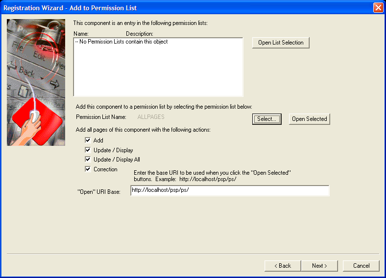

  8. You see the Add to Permission List page.
    This example illustrates the fields and controls on the Registration Wizard - Add to Permission List dialog box. You can find definitions for the fields and controls later on this page.
    Click the Select button to find the menu name, and then use the drop-down list box to select the name that appears in the bar.
    Menus are used as logical groupings to which you can apply security. PeopleSoft components are addressed by menu name (the URL includes the menu name). To add this component to a menu, specify the menu name and bar name.
    If you did not select the Add this component to a menu check box on the Prompt page, this page displays the menu name and the Select button only. You then must select the correct menu that already contains the component.
    If you are working with an iScript, you must select the iScript function to register.
