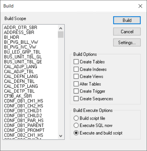

Access all of the commands and options that are associated with building tables, views, indexes, triggers, and altering tables from the Build menu. When you choose to build an item from the Build menu, the tasks for creating or running SQL scripts that define the underlying database components are included in the Build dialog box.
This example illustrates the fields and controls on the Build dialog box. You can find definitions for the fields and controls later on this page.
Build dialog box

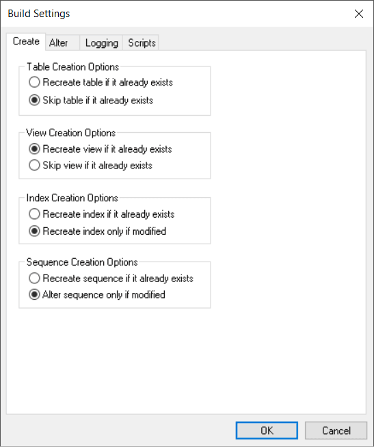

The settings for the Build process in the Build Settings dialog box enable you to configure various aspects of the process. Depending on which build option you are running, your settings vary. The Build Settings that you select are stored on your workstation so that they can be reused during future PeopleSoft Application Designer sessions. Access the Build settings by selecting Settings from the Build menu in PeopleSoft Application Designer or click theSettings button in the Build dialog box.
This example illustrates the fields and controls on the Build Settings dialog box. You can find definitions for the fields and controls later on this page.
When you select the Create Tables, Create Indexes, Create Views, or Create Sequences options in the Build dialog box, specify the appropriate options on the Create tab of the Build Settings dialog box. For example, you might need to specify whether an existing table, view, index, or sequence is skipped or dropped and then recreated.
