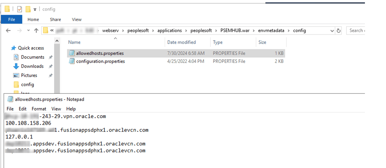

If the EM Hub server uses the connection type HTTP or one-way SSL, then the client hostname or IP address need to be added to the allowedhost.properties file so that the client host is allowed to make a connection request.
The allowedhost.properties file is available in /webserv/peoplesoft/applications/peoplesoft/PSEMHUB.war/envmetadata/config/.
This example illustrates the sample allowedhost.properties file.
Allowed Host Properties file
Note that the local host IP 127.0.0.1 is added by default to enable local PSEMAgent to ping EM Hub running on the same server. You can remove this IP if not required.
In the application log file, you will find logs that shows rejected connection requests from clients that are not added in the allowedhost.properties file. Use the information in the log file to resolve the connection issue.
