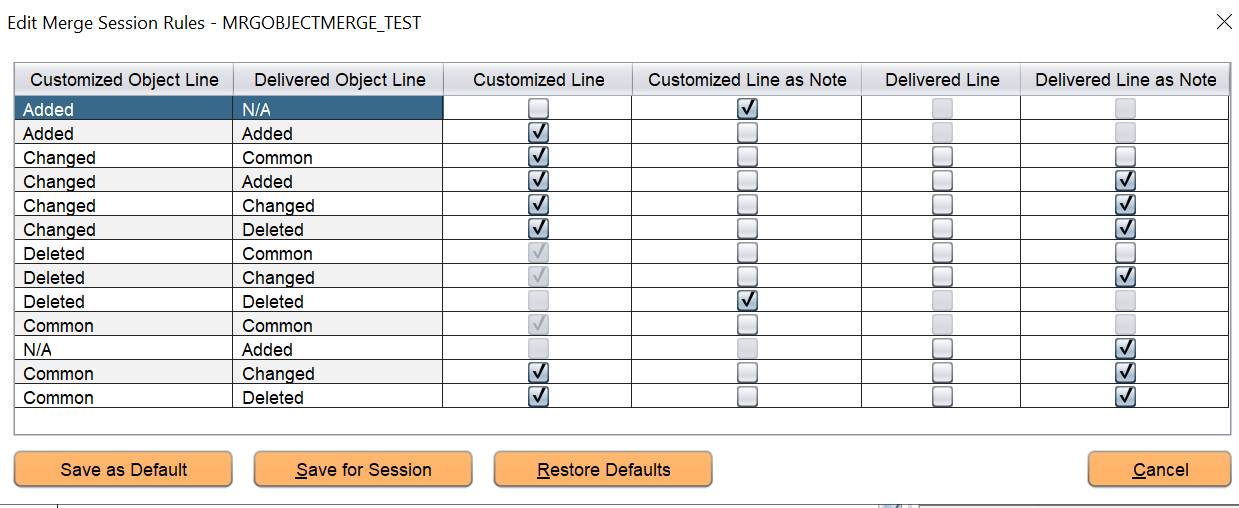

This example illustrates the fields and controls on the Edit Merge Session Rules page. You can find definitions for the fields and controls later
Field or Control Description
Save as Default
Lets you to save the modified merge rule as default.
This option is enabled when you modify the current merge rules.
If this is disabled, then the rule that you see currently is the default merge rule.
You can also directly modify the rules on the Edit Merge Session Rules window and save as default. Note that the modified rules will be used only in the future merge sessions.
Save for Session
This is enabled when you select or de-select the check boxes on the Edit Merge Session Rules window for modifying the current merge session rules.
This option lets you to modify the merge rules of the current merge session without modifying the default global merge rules, which is defined in Tools, Options, PUM Source tab.
You can modify the merge rules multiple times until there is a satisfactory result.
Restore Default
Lets you to restore the PeopleTools-delivered merge rules.
