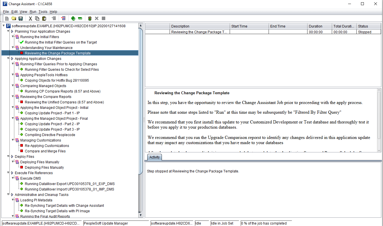

This example illustrates the fields and controls on the Change Assistant interface. You can find definitions for the fields and controls later on this page.
Job open in Change Assistant
When you have a Change Assistant template or job open, you use these areas in the project workspace:
Interface Area Description
Template tree
The template tree section displays distinct nodes for the chapters, tasks, and steps within a template.
  • Chapters are section dividers that group and display the tasks.
  • Tasks are section levels that contain one or more steps.
  • Steps are the actual update actions that complete the processing of your update job.
Note: Properties are assigned at the step level in the template, not the task or chapter level.
Properties box
Depending on what is selected in the template tree, the properties box displays the properties associated with that node.
For the Create or Modify Templates action, the properties box displays the properties assigned to the step when it was defined.
For a job, the properties box displays information related to the progress of a step, such as start time, end time, total duration, and so on.
Documentation box
Each template contains its own built-in documentation to provide guidance for a chapter, task, or step. The documentation exists in separate HTML files, but it appears in this box for each selected node on the template tree.
Activity box
The Activity box displays the processing and status messages associated with a step, when a job is running in Change Assistant. This is similar to the Output window in the Application Designer workspace.
