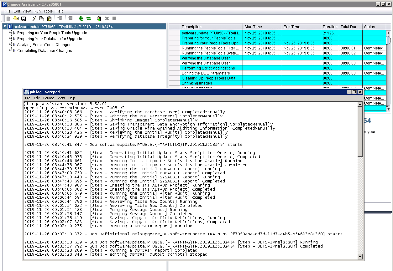

The job log is located in the folder generated for the change package job in the output directory defined on the Change Assistant General Settings page, for example C:\CA\output\updPACKAGE1_1476310350534\job.log.
You can also access the job log from Change Assistant by right-clicking on the job name and selecting View Log.
This example illustrates accessing job log from Change Assistant. Right-click on the job name and select View Log.
Accessing job log from Change Assistant
The job log includes:
  • Check Compatibility Page
  • Apply Summary Page
  • PI Environment
  • Step/job execution status during job execution
