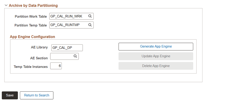

  3. Access the Manage Archive Objects page (PeopleTools, then Data Archive Manager, and then Manage Archive Objects).
    This example illustrates the Archive by Data Partitioning portion of the Manage Archive Objects page before AE generation.
    Manage Archive Objects by Data Partitioning page before generation
  4. In the Archive by Partitioning section, specify the following:
    • For Partition Work Table, select the work table from step 1.
    • For Partition Temp Table, select the temp table from step 2.
    • Enter a name for the AE program in the AE Library field.
      The AE Library has two purposes:
      • To contain any optional logic to be run prior to populating the work table when using the Data Partitioning option.
      • Temp Table defined for the data partitioning will be associated with this AE library.
    • Leave the AE Section field blank as this gets set automatically to "PrePro" upon App Engine generation.
      PrePro will be the initial placeholder section in the generated App Engine that can be used for any optional logic to be run prior to work table population, if required.
    • Enter the number of Temp Table instances to assign.
      The number of instances specified at this stage should be at least twice the maximum number of concurrent AE Processes that can be run on the server.
  5. Click Generate App Engine to automatically create the AE program/section.

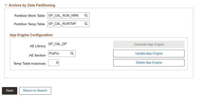

    The generated AE will be automatically associated with the specified Temp Table.
    This example illustrates the Archive by Data Partitioning portion of the Manage Archive Objects page after AE generation.
    Manage Archive Objects by Data Partitioning page after generation
  6. Save the Archive Object.
  7. In Application Designer, open the Temp table definition created in step 2, and build it.
Optional Additional Steps
  • The AE section "PrePro" does not contain any code by default, but can optionally be modified to include pre-processing logic that should be run prior to the selection and insertion of dataset keys into the work table. Note that this will be run in addition to any existing pre- and post- processing AE programs specified in the Data Archive Template definition.
    Additional custom AE sections can be created in the App Engine if desired (for example, to contain pre-processing logic for different scenarios). The AE Section field can be used to look up and select another such AE section if necessary.
  • If the number of Temp Table instances needs to be adjusted, modify this field value and click on the "Update App Engine" button to update the App Engine.
    Remember to rebuild the Partition Temp Table in App Designer after this step.
  • The Delete App Engine button can be used to delete the associated App Engine if necessary.

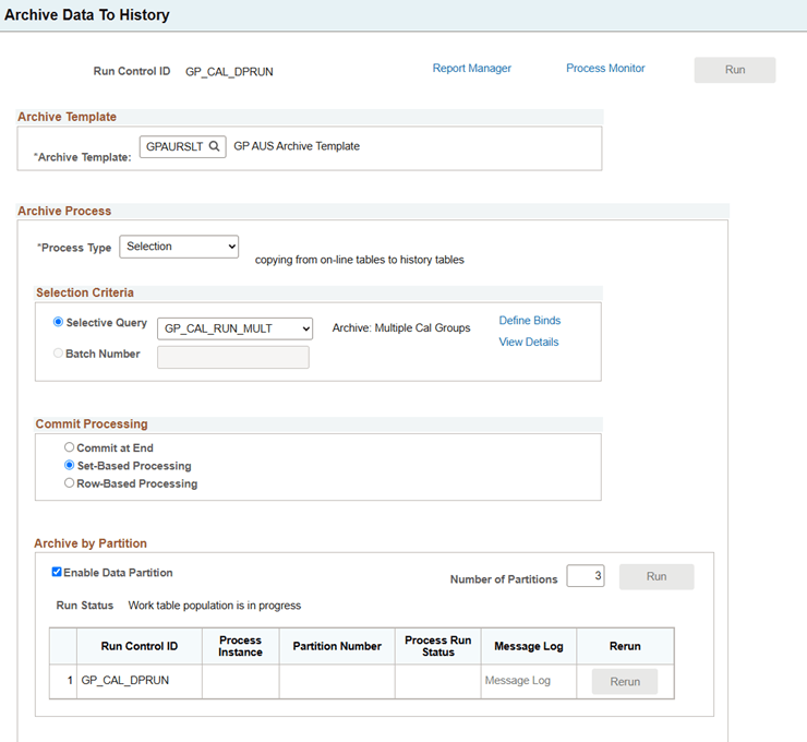

  1. Access the Archive Data To History page (select PeopleTools, then Data Archive Manager, and then Archive Data to History.
    This example illustrates the Archive Data To History page.
    Archive Data to History page
  2. Select an Archive Template that uses this Data Archive Object.
  3. In the Archive By Partition section, select the Enable Data Partitioning option, and specify the desired number of partitions to create.
    There is no need to limit the number of partitions requested to the number of Temp Table Instances that have been built. Instead, it is important to ensure that the number of temp table instances that have been built are twice as many as the maximum number of AE Processes that can be run on the server concurrently.

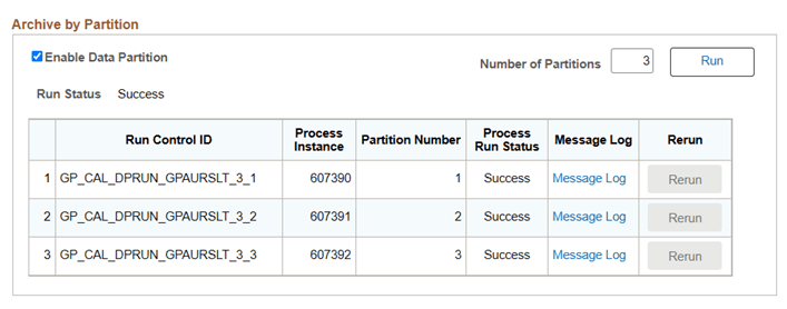

  4. Click Run to start the PSARCHIVE_DP AE program, which will in turn do the following:
    1. Run any code in the specified AE Section (optional).
    2. Populate the Work Table, partitioning the data in as many partitions as requested.
    3. Spawn a separate PSARCHIVE process for each partition that was created. Each of these process will procure its own Temp Table instance, and will populate it with the specific data belonging to the single partition assigned.
  5. Follow the progress on the Archive By Partition grid, which displays the status of each of the spawned PSARCHIVE processes.
    If an error occurs, click Rerun to restart the process.
  6. When all processes have completed successfully, the Run Status above the grid will be updated to Success, as shown in this example.Archive by Partition section
