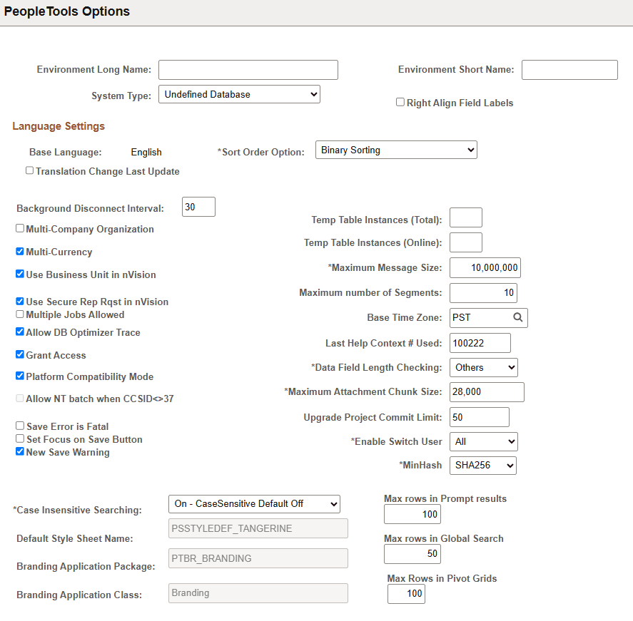

Select PeopleTools, and then Utilities, and then Administration, and then PeopleTools Options to access the PeopleTools Options page.
This example illustrates the fields and controls on the PeopleTools Options page.
The base time zone that you define for PeopleTools must match the time zone used by your database. Any discrepancy between the two leads to inaccurate time processing.

  1. Select a time zone from the Base Time Zone field.
