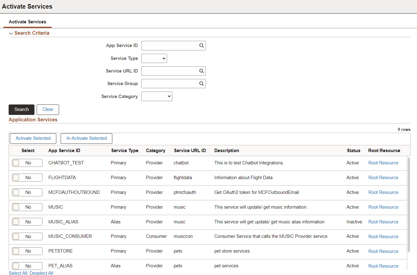

This example illustrates the fields and controls on the Activate Services page. You can find definitions for the fields and controls later on this page.
Field or Control Description
Search
Expand the Search section to search for Application Services based on Application Service ID, Service URL ID, Service Type, Service Group, and Service Category.
Activate and Inactivate button.
To activate or inactivate, select the appropriate button.
Select
Select the Application Services in the grid by selecting each row or by selecting the Select all at the bottom of the grid. The status of each selected row will be updated based on the activate option that is selected.

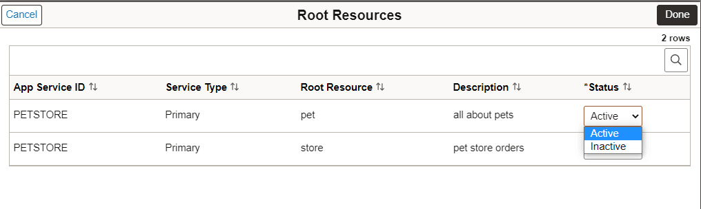

Activating or Inactivating Root Resource
The administrator can activate or inactivate root resources by selecting the appropriate root resource link.
This example illustrates the fields and controls on the Root Resources page.
Activate Root Resource page
Select the status for the root resource and click Done.
