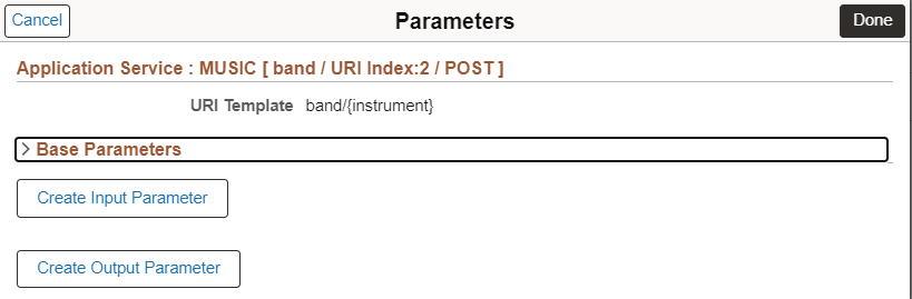

Use the Create Input Parameter and Create Output Parameter buttons to add additional parameters.
Add input or output parameters

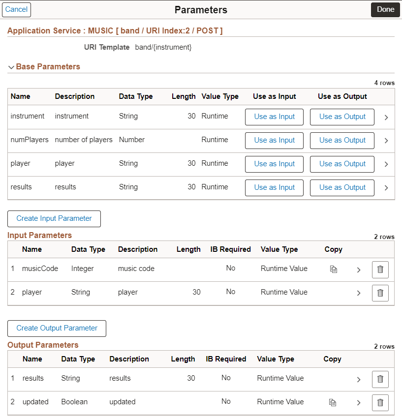

Selecting Base Parameters
Base parameters can be defined once and used as inputs or outputs in multiple URIs. Expand the Base Parameters section to select an existing base parameter.
This example illustrates the fields and controls on the Parameters page. You can select to use the existing parameters as input or output.
List Existing Parameters
When you select Use as Input or Use as Output, the parameter is added in the appropriate section.
The parameter is added as input or output depending on the option selected. To view or modify the parameter details for this URI select the > icon.

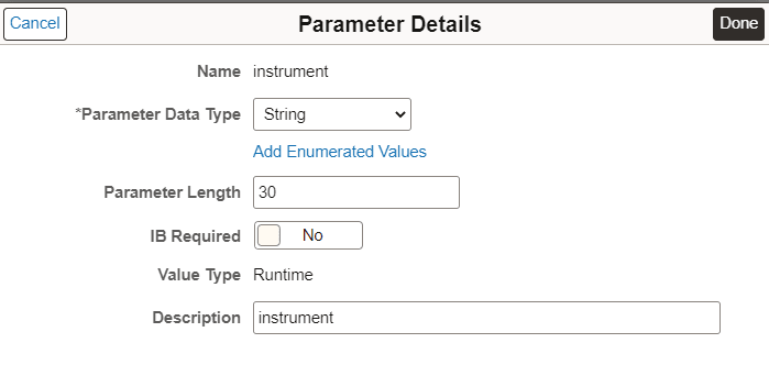

This example illustrates the fields and controls on the Parameter Details. You can find definitions for the fields and controls later on this page.
Parameter Details page
Depending on the Data Type selected, the fields appropriate fields for the data type are displayed, however the following fields will always appear.
Field or Control Description
Parameter Data Type
Displays the parameter data type of the base parameter. The data type can be changed for this URI, however if you try to update the base parameter with that change a warning message will be displayed.
IB Required
Select Yes to indicate this is a mandatory parameter.
Value Type
For output parameter, the value is read only and will always be Runtime.
For input parameter, select Runtime or Fixed.
If Fixed is select, a field to enter the Parameter Value is displayed.

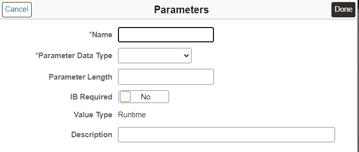

When you select to add a new input or output parameter page, the Parameter Details page is displayed.
This is an example of the parameters page for a new output parameter.
New output parameter
Parameter Data Type
IB Required
Value Type

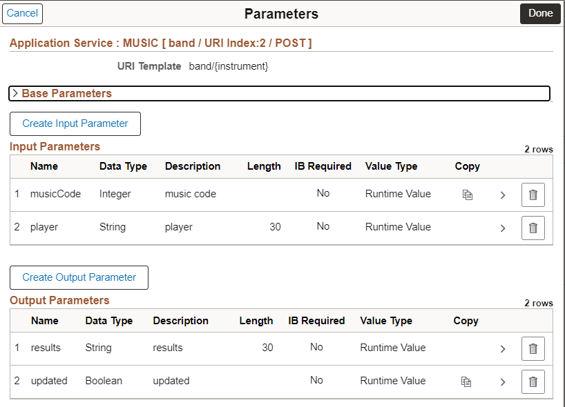

This example illustrates the fields and controls on the Parameter page that includes input and output parameters. You can find definitions for the fields and controls later on this page.
Parameter page showing input and output parameters
Use the Copy icon to add the new parameter to the Base Parameters. If the parameter already exists in base parameters, the copy icon is not available.
