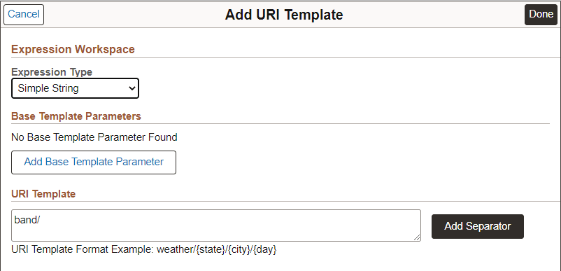

Use the Add URI Template button on the Root Resource page to access the URI Template Builder.
This example illustrates the fields and controls on the Add URI Template page. You can find definitions for the fields and controls later on this page.
The URI Template Builder is divided into 2 sections:  Expression Workspace and URI Template.
Field or Control Description
Expression Type
Simple String is the default. Simple String is used for Provider REST web services. Other styles are available from the drop down list.
See Understanding URI Template Expressions and Expansions.
Add Base Template Parameters button
Select to add additional base parameters.
See Adding Base Template Parameters.
Parameters defined on the Base Template Parameters page can be selected to build out the URI.
URI Template
The Root Resource must always be the first string defined for the URI Template.
See Building the URI Template
