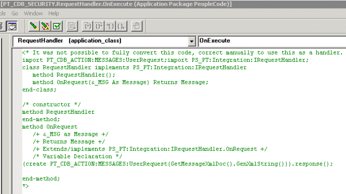

This section discusses correcting non-migrated PeopleCode and creating an Application Class type handler.
The following example shows an application class created for the PeopleTools 8.47 or earlier message PT_CDB_SECURITY. During the upgrade process, the system was unable to migrate the integration PeopleCode defined on the message.
This example illustrates a PeopleTools 8.48 application class created for the PeopleTools 8.4x message PT_CDB_SECURITY.

  1. In PeopleSoft Application Designer, open the migrated application package.
    The package name is generally the same as the message name in the PeopleTools 8.47 or earlier system.
  2. Remove the “<*” and “*>” symbols, as well as the comments from the code.
  3. Compile the code.
