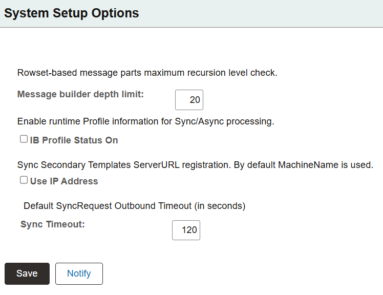

By default, the system checks up to 20 levels for recursion to ensure that no message part references itself. You can modify this setting to check for recursion in as few as three levels of records and as many as 50 levels.
This parameter is set on the System Setup Options page (IB_SYSTEMSETUP).
This example illustrates the System Setup Options page.
To modify the recursion checking level:
  1. Access the System Setup Options page (select PeopleTools, and then Integration Broker, and then Configuration, and then Integration Broker Options)
  2. In the Message Builder Depth Limit field, enter a value between 3 and 50.
  3. Click the Save button.

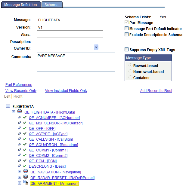

A referenced message part appears highlighted in the tree structure for a message in the Messages – Message Definition page.
This example illustrates the Messages – Message Definition page. In the example the message structure for the FLIGHTDATA message is shown. In the tree structure the message record QE_ARMAMENT is highlighted and is therefore a referenced message part in the FLIGHTDATA message.

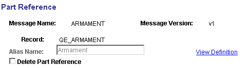

If you click a referenced message part, the Part Reference page (IB_MESSAGE_PARTS2) appears.
This example illustrates the Part Reference page.
Part Reference page
You can use the Part Reference page to view general information about the referenced message part as well as view the complete definition for the message part.
You can also use this page to delete the reference to the message part. Deleting a part reference is discussed elsewhere in this section.

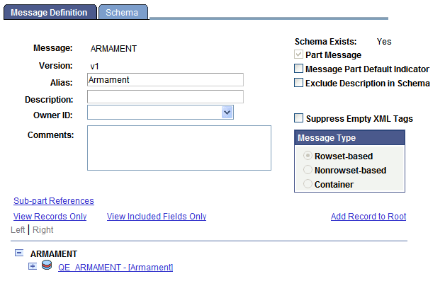

To view the complete message definition for a referenced message part, on the Part References page View Definition link shown in the previous example. When you click the link the definition for the referenced message part appears in the Messages – Message Definition page.
This example illustrates the Messages – Message Definition page. The example shows the message definition for he Armament message part.
Messages - Message definition page
You can use the page to view details about the record structure, view the generated message schema, and so on.

You delete a referenced message part in the message where the part is referenced.
To delete a referenced message part:
  1. Open the message definition that contains the referenced message part to delete.
  2. In the tree structure view of the message definition, click the name of the referenced message part to delete.
    The Part Reference page appears.
  3. Select the Delete Part Reference check box.
  4. Click the OK button.
