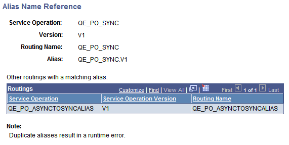

This example illustrates the Alias Name Reference page. The example shows the that the external routing alias QE_PO_SYNC.V1 is used for the current routing definition, QE_PO_SYNC, and for the routing definition QE_PO_ASYNCTOSYNCHALIAS.
The Alias Name Reference page appears only if the system finds that the external alias on the current definition also exists on one or more other routing definitions. If the system finds that the external alias is not used on any other routing definitions, it displays a message indicating so.
The Alias Name Reference page appears only if a duplicate external alias exists on another routing definition.
Duplicate external routing alias names are never allowed for synchronous routing definitions and the system generates an error at runtime if it encounters any.
In most cases duplicate external routing alias names are not desired for asynchronous routing definitions. The exception is when you are using service operation mapping, and you want one routing definition to invoke multiple service operations.
To remedy the problem of duplicate external routing alias names, create unique alias names for each duplicate found.
