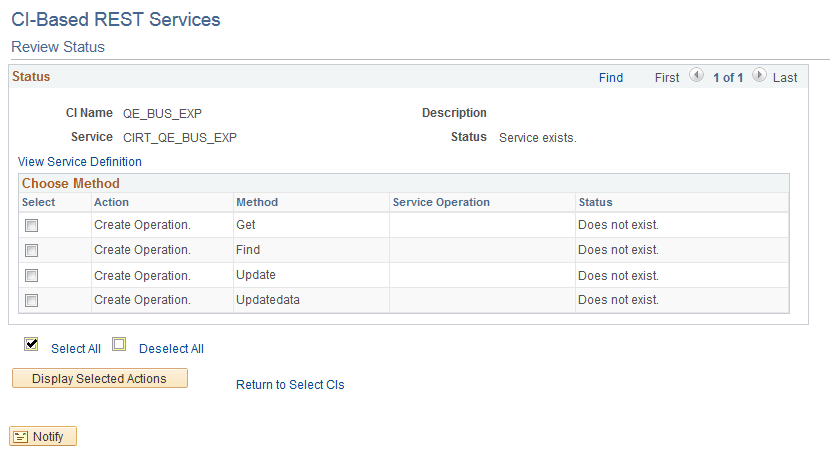

This section discusses using the Review Status page (IB_CISERVICES2) to select methods to include REST services as service operations.
This example illustrates the fields and controls on the Review Status page. You can find definitions for the fields and controls later on this page.
Review Status page
The Review Status page shows the following information about the component interface you select to expose as a service:
