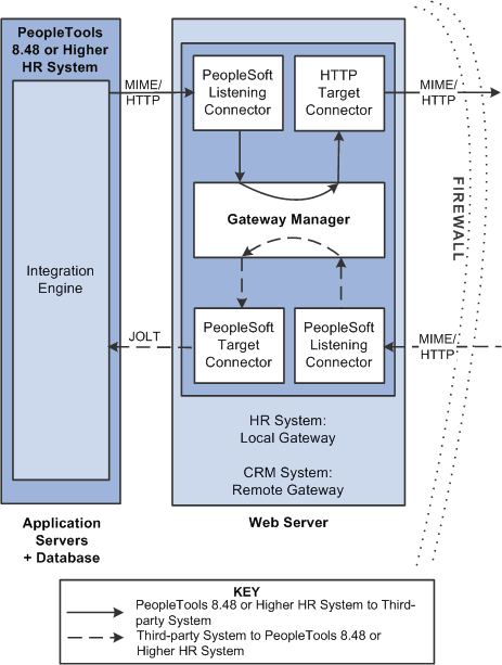

Understanding This Scenario
This diagram shows a high-level view of how to integrate with third-party systems by using remote gateways:
This diagram shows a high-level view of a PeopleSoft system integrating with a third-party system by using a remote gateway.
High-level view of a PeopleSoft system integrating with a third-party system by using a remote gateway.
Integrations from one integration gateway to another can only be sent when they originate from a PeopleSoft system. The only exception to this is when integrations are performed through a custom connector that makes use of the IBRequest methods needed to handle this routing.

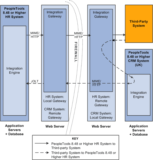

The following diagram provides a more detailed view of the configuration on the PeopleSoft system:
This diagram illustrates the configuration on the local PeopleSoft system for integrations with third-party systems using remote gateways.
Configuration on the PeopleSoft system for integrations with third-party systems using remote gateways.

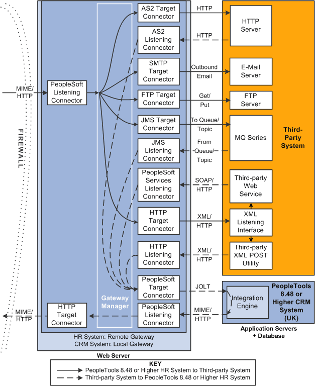

The following diagram provides a more detailed view of the configuration on the remote PeopleSoft system and the third-party system.
This diagram illustrates the configuration on the remote PeopleSoft system and on the third-party system for integrations with third-party systems using remote gateways.
Configuration on the remote PeopleSoft system and the third-party system for integrations with third-party systems using remote gateways.
